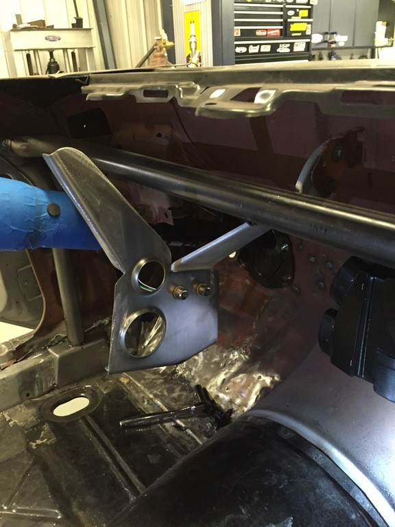

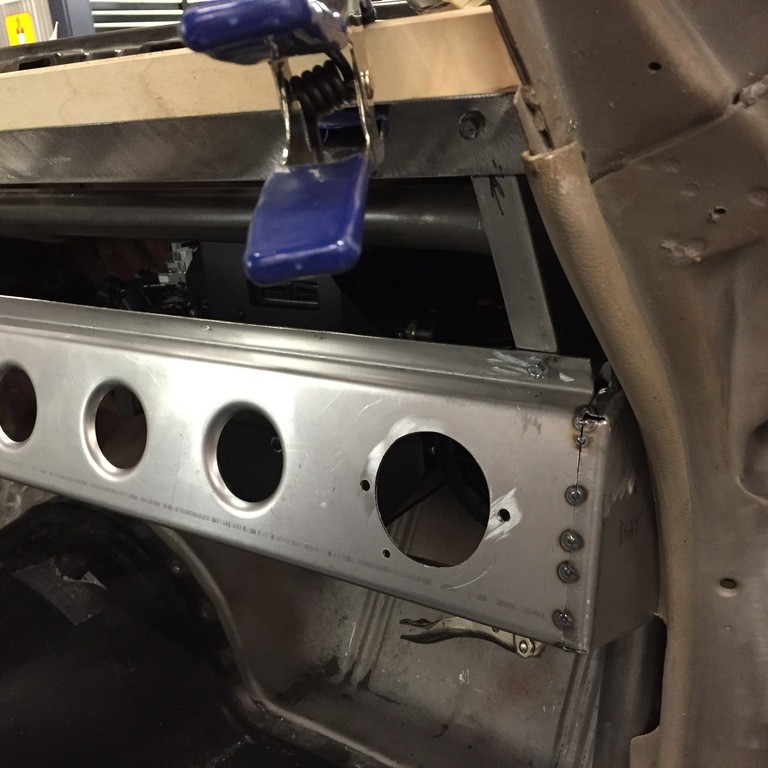

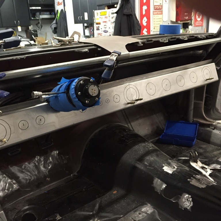

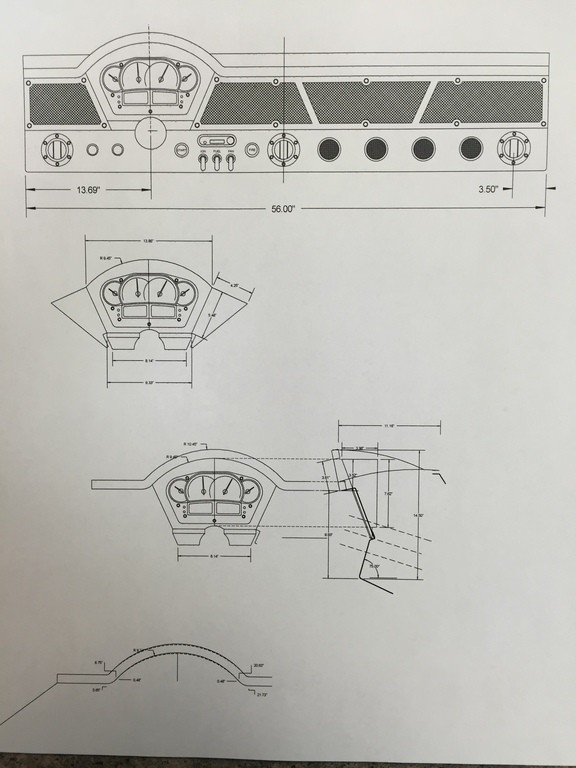

Never did care for the stock dash in the second gens. I also wanted to use one of the Dakota Digital VHX-1100 instrument clusters so I decided to build the dash from scratch. Did a cad drawing first, the dark areas are going to be carbon fiber with the trim around it 1/8 aluminum painted black. The 4 dimples will have the same stainless mesh behind them as the "rear seat" compartment. The vents on either end and in the middle are the Restomodair Synister style like the AC bulkhead in an earlier pic
Bent up the lower piece and temporarily supported it in place to try and decide if it was feasible (or if I was in over my head lol)

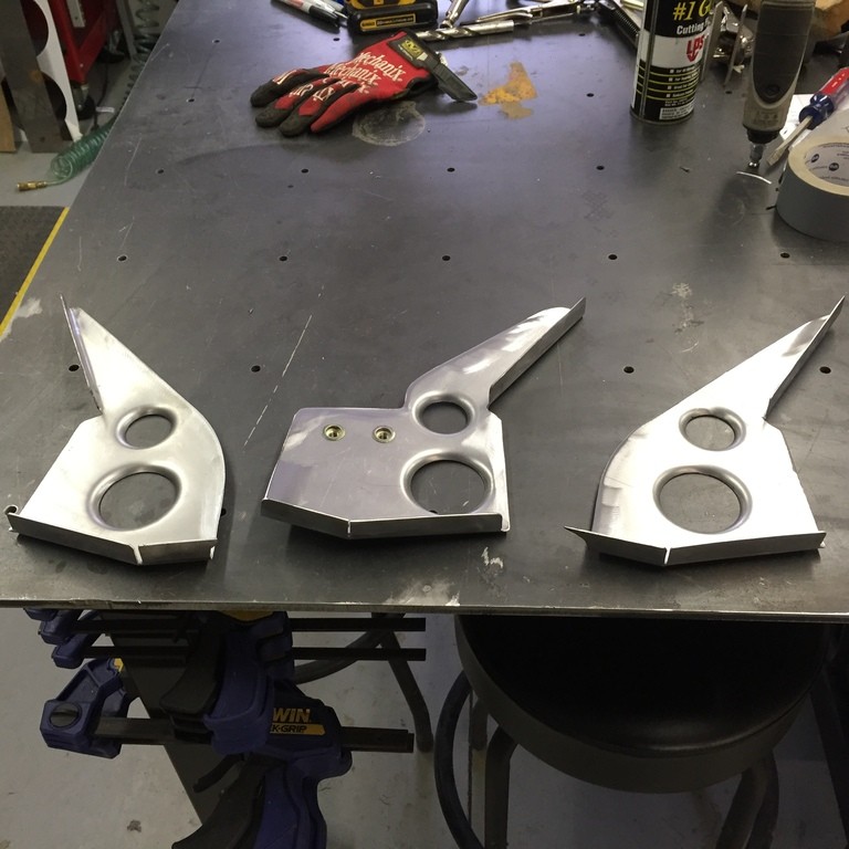

Then I fabbed these brackets to support the whole works.
The outer two are welded to the cage and the center bracket attaches to the factory center dash support
Steve

Cut the front edge of the dash top out of 3/4 mdf on one of the cnc's at the cabinet shop. Pretty handy lol
Mocked up the "can" for the gauges using poster board
Taylor cut the can out on the waterjet
Steve

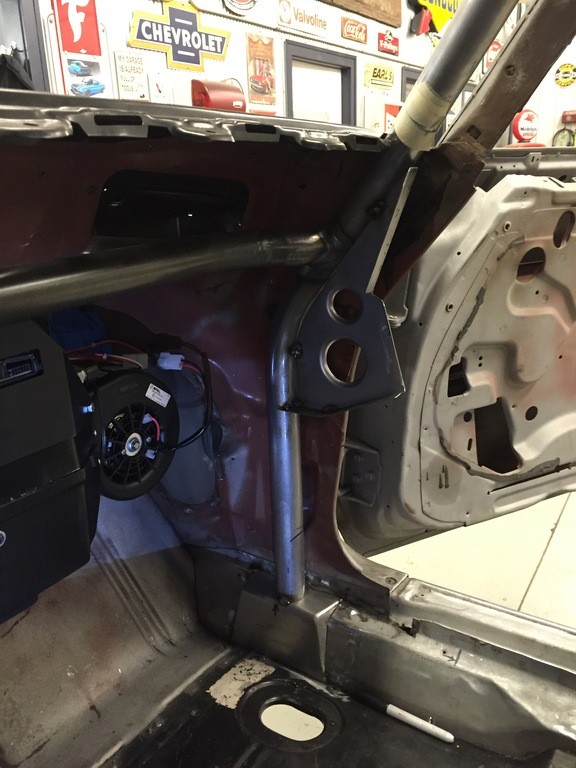

Question about your kick panel vents, are you sealing them up? How are you going about it?

Thanks, Pic coming up!! lol We welded a panel over the pass. vent hole from the outside when we had the cowl area open to mount the oil tank there. Going to weld a panel over the driver side also.
