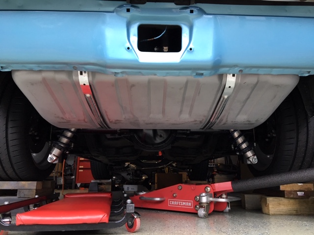

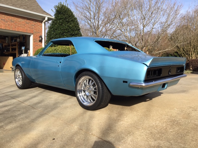

Got the Ridetech 4-link brackets welded on the 8.5" 10 bolt and got the rear suspension wrapped up. It's dirty, but I rolled it out since the sun was out and snapped a few photos with the new wheel/tires.

Car looks great,I am sure you excited with the progress.Seems like paint is always a major accomplishment

Installed a new gas tank and Ridetech gas cap.

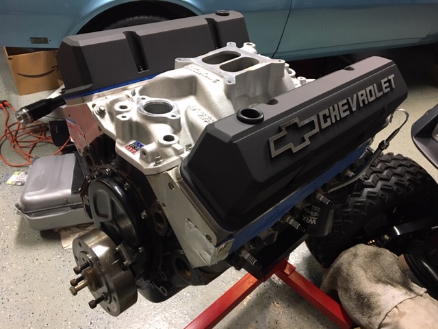

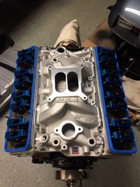

I picked up a 383 stroker. Been changing out some of the engine top end. Got the new intake and valve covers on.

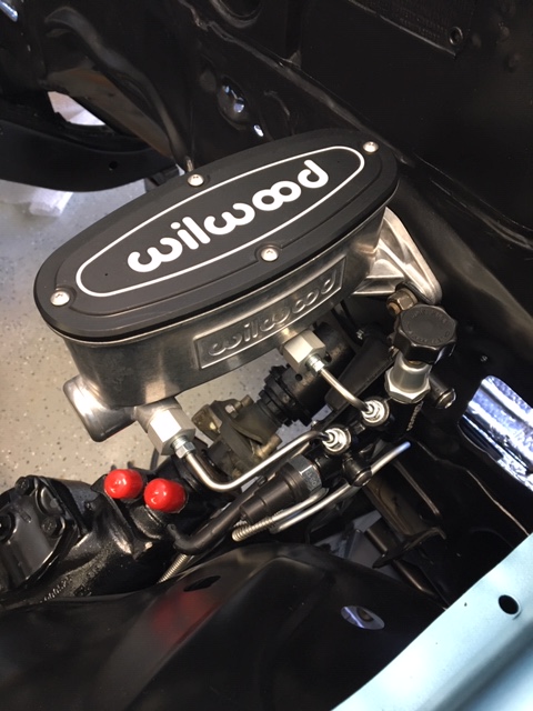

I got the master cylinder, prop valve, and brake lines installed. Along with some new hood hinges.

**(In ref to the engine photo, do I still need to install the balancer center bolt???)

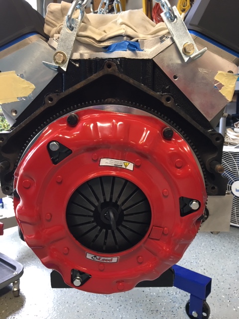

My clutch and flywheel showed up so I plan to install those this week. Hope to get the trans installed also and drop the engine/trans in this weekend.

yes you still the center bolt. Its what holds the balancer to the crank

x2 Get and ARP one at this point if you don't already have a center bolt.
