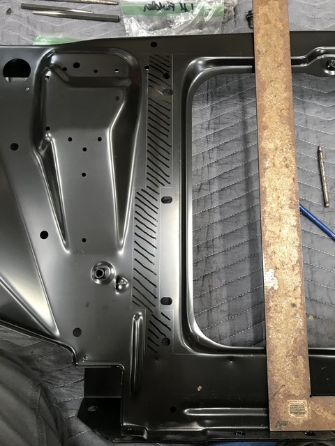

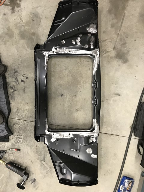

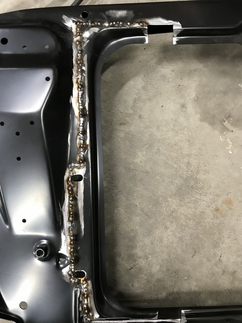

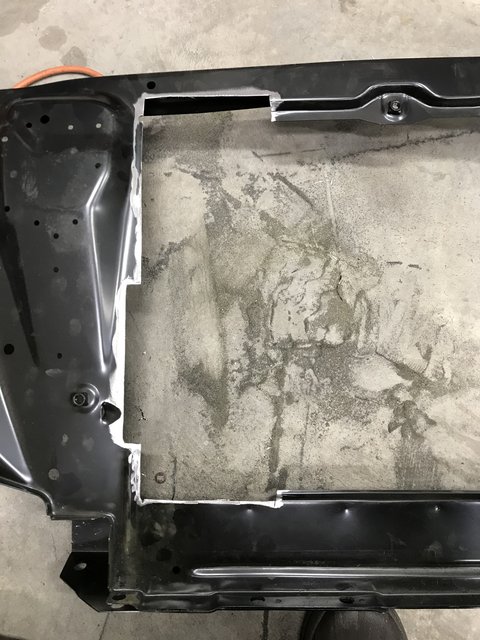

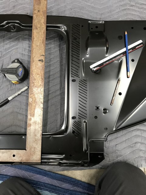

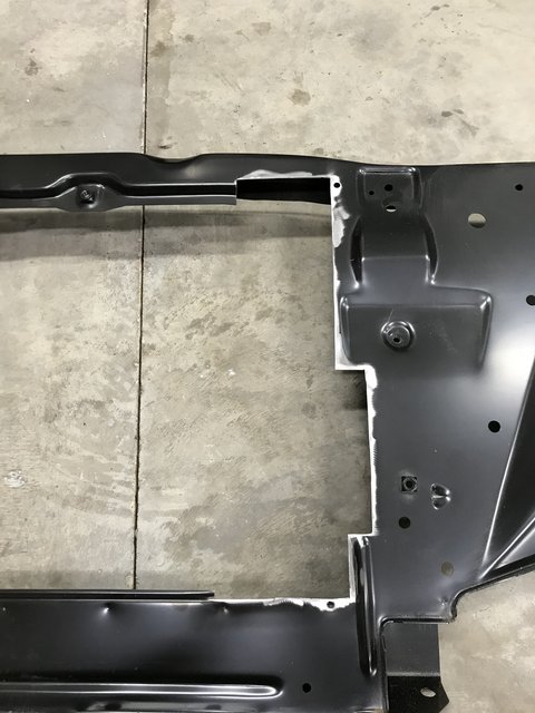

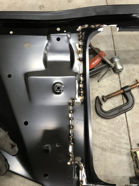

My original core support was in horrible shape. It had been hacked up, and patched to many times. I ordered a Goodmark replacement. The opening in the stock support is fairly small at 21” wide. I have seen a lot of folks just cut the opening larger, but it just never looks finished. I also wanted to fill a lot of holes I don’t plan to use and get rid of the dimpled area for the original radiator cap.
I laid out a plan to cut out sections to increase the opening while retaining the original flange. I was able to increase the opening to 24” wide. I’m still working on my welding skills but overall I was pleased.

It was a little intimidating to cut up a brand new core support.
