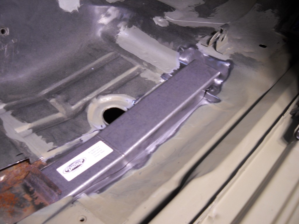

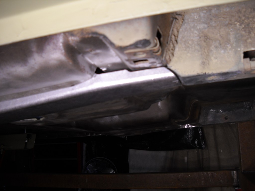

since I had an update. MY school work is taking most of my time lately, but I told myself I needed to get out there and get some stuff done before it gets too cold out.

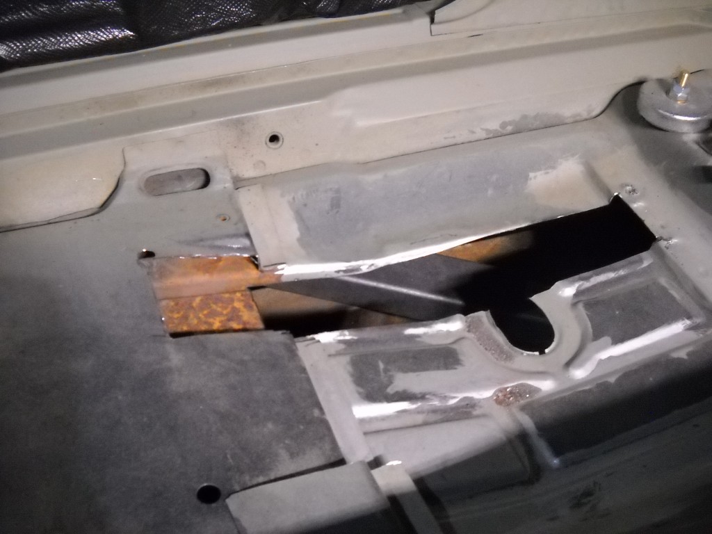

So I cut out the floor for the sub frame connectors, got the drivers side done and most of the pass side. After I cut up the floor supports and found rust I said that's the last sheet metal that I haven't torn apart .... figured, rust had started everywhere else!!
I'll use some Eastwood frame rust inhibitor all through the support and weld her shut.
Question for those before me: the connector DSE gives you to weld the frame and connectors together ... what's peoples doing for a removable frame setup?? Any templates? Any recommendations for strength?
I can't cut 3/16" and make it look good, suggestions?
Drivers side nice and snug, should be easy weld here!
Pass side cut out, yeah RUST !
What to do about that gap prior to welding????

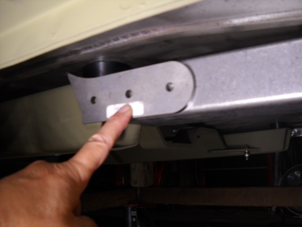

This is the DSE connector .... like to replace it with a bolt thru on the frame.

Not that it makes a whole lot of difference right now but are you by chance holding that subframe tab upside down in the last picture?
As usual I will watch and learn Chief, I have these sitting new in box for my '68.
I will admit I have had second thoughts about cutting into her especially with some of the bolt on or less invasive weld on subframe connector offerings.
I bought them because I deemed them to be the best cure for stiffening the chassis and the cleanest underside once completed.

Yeah I'm probably holding it upside down .... the point is the bracket was made to weld the two together, not too keen on that!
Think I'll head over to the metal dist. and see if I can find some square stock and match the connectors od with its id and make something longer to mate them up.
