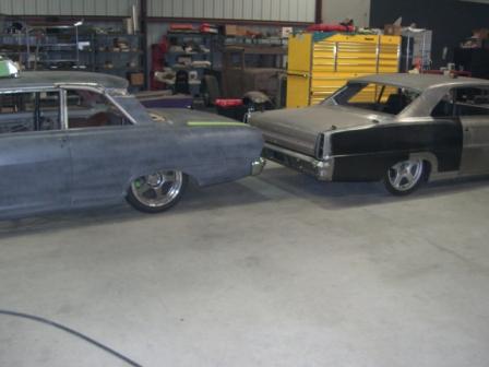

Some pics from Today. We will install the front crossmember and bend up the next section of the rear rails tommorrow.
Rodger
