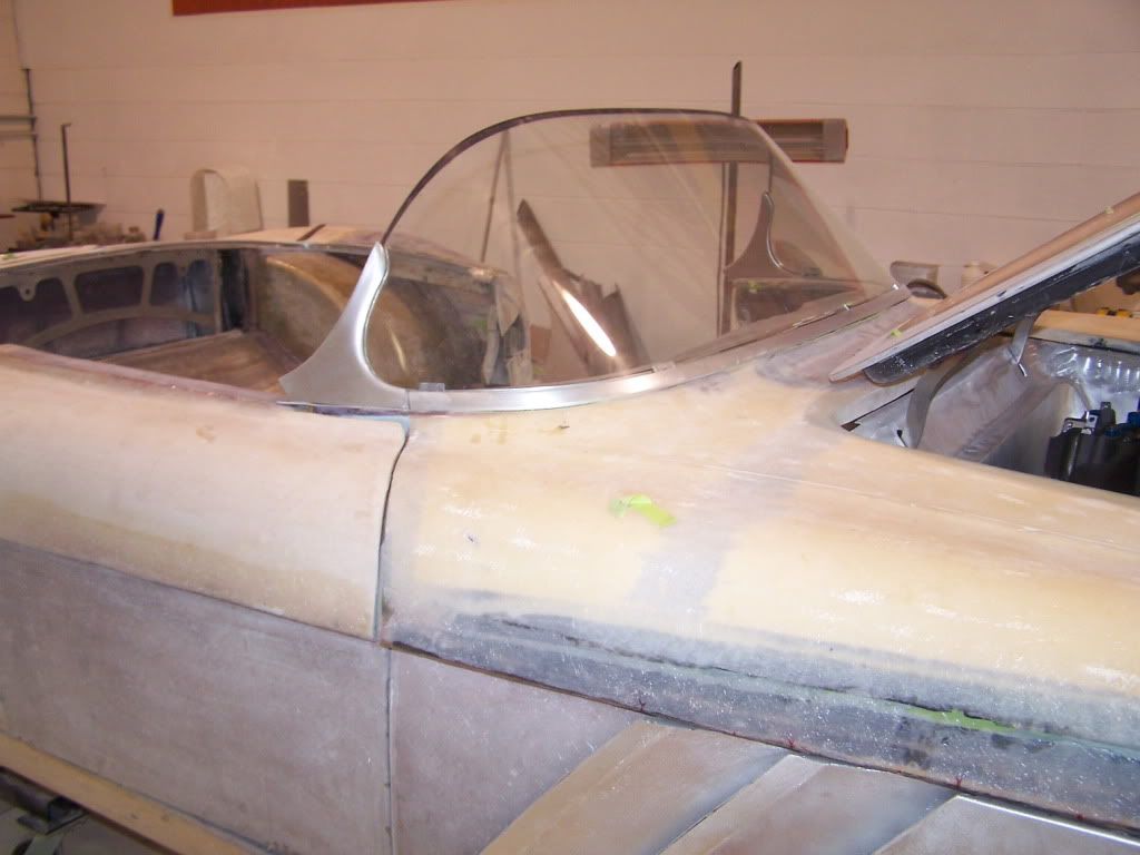

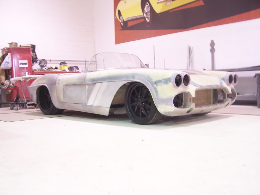

eliminated the stock windshield trim and fabricated a complete new design. The top of the cowl was changed for a smoother transition. The windshield was also trimmed down and leaned back for a mroe aggressive profile.
Assembled and set on the ground for the first time!

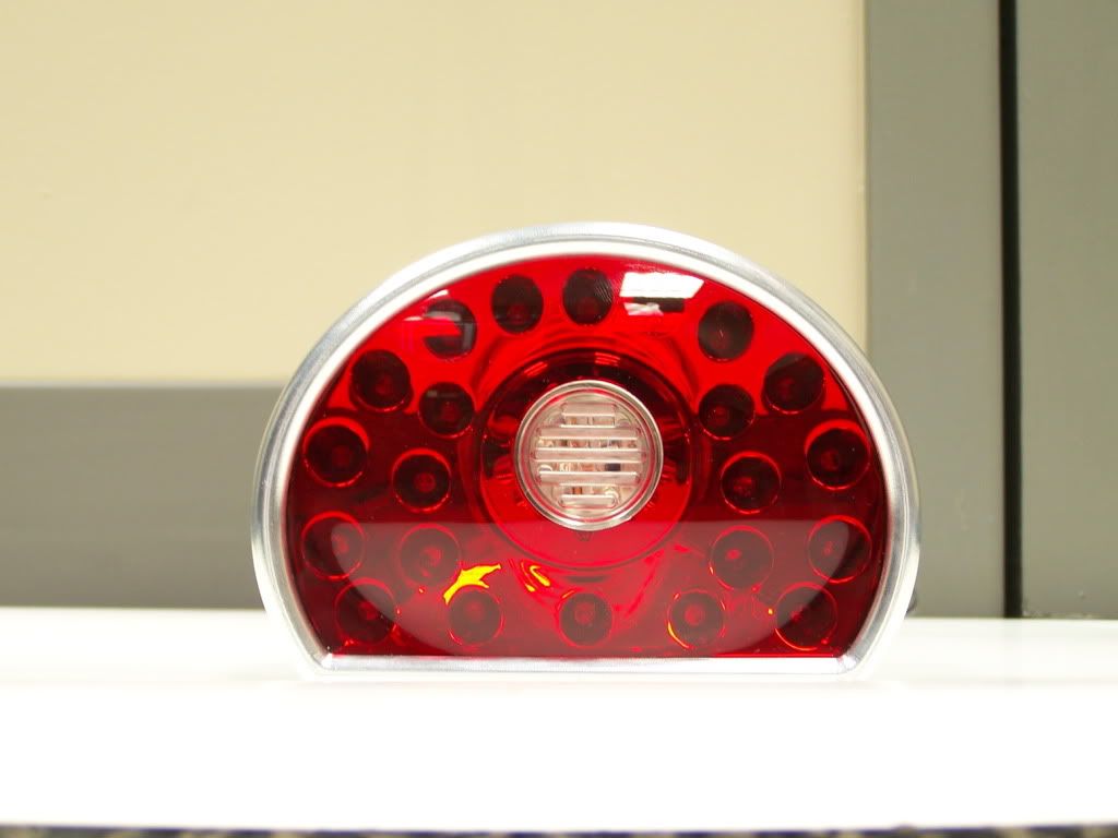

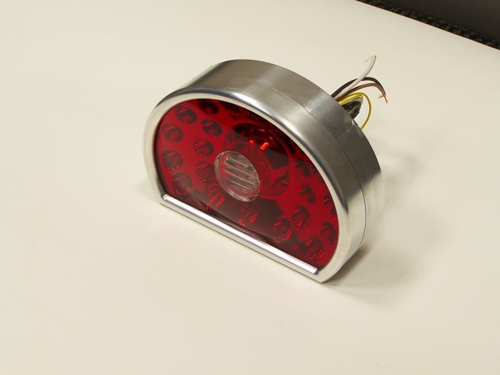

Posts: 1,120
1-off billet, LED tail lights
www.roadstershop.com
