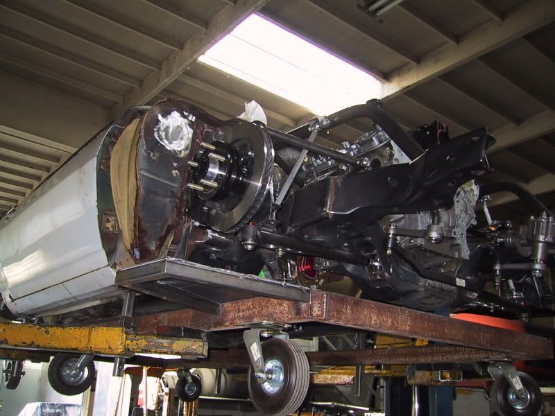

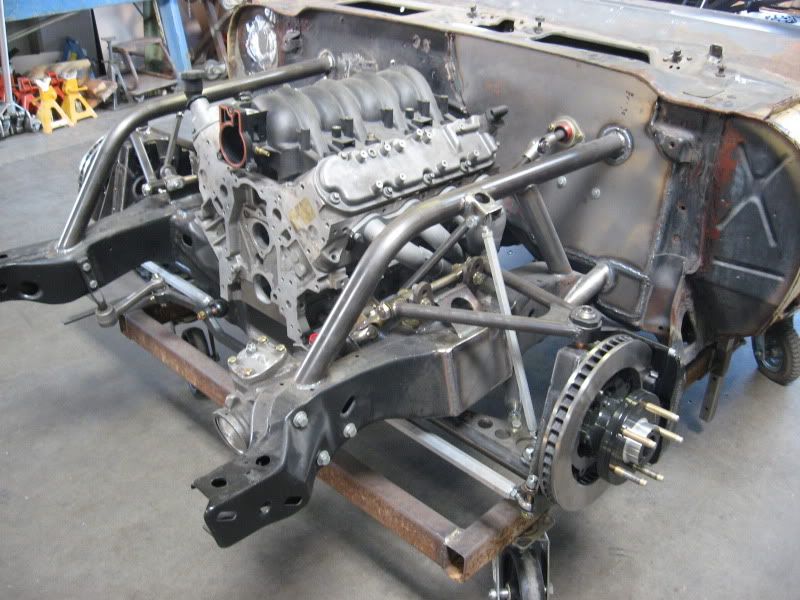

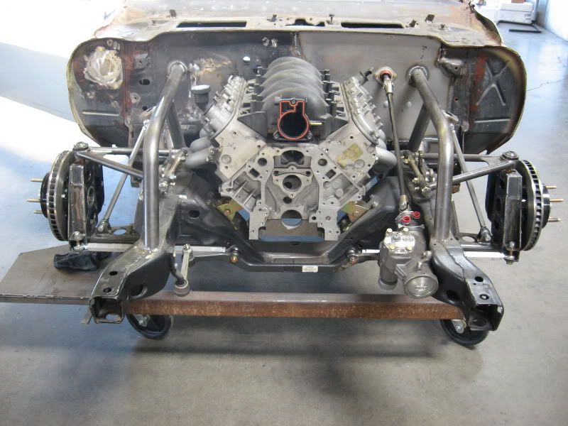

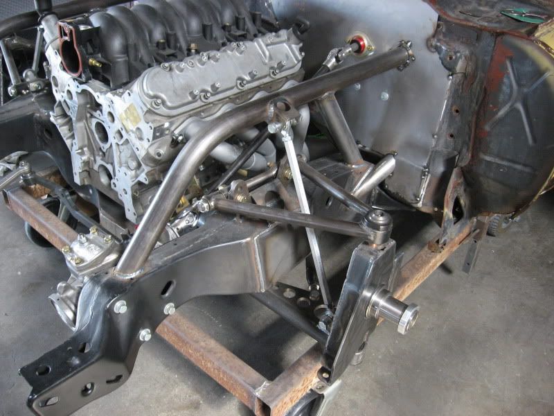

Here are photos showing the front structure near completion. The cross bars are still to be installed.

Posts: 216
Is the subframe welded solid to the body ? Is it still possible to square the frame up with the body ? may be a better way of wording it
Sorry if it was already discusssed .
The subframe is bolted to the body at the normal location with metal bushings instead of rubber. The bottom of the car has a subframe connector set up that is all welded together, tying it in with the cage assembly. Everything was squared up already.
