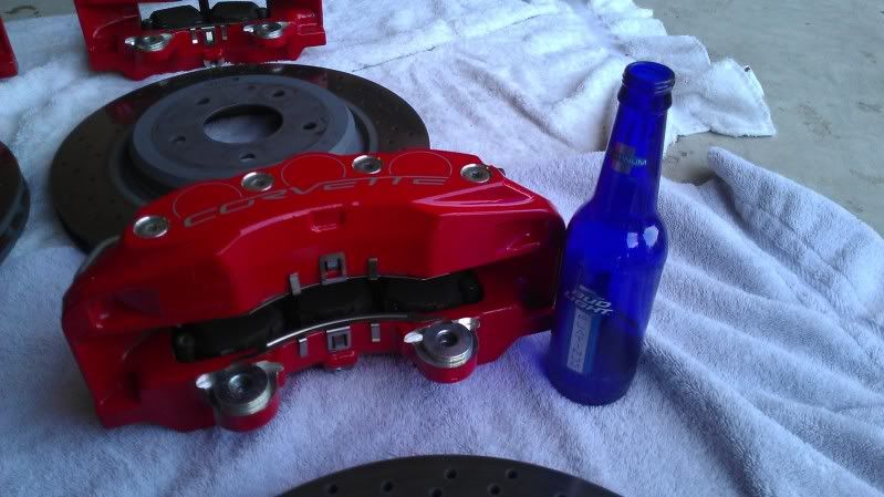

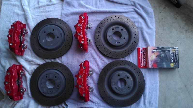

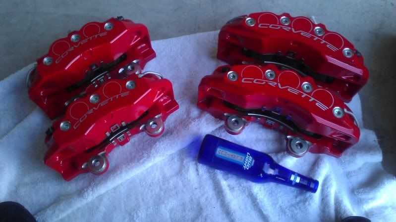

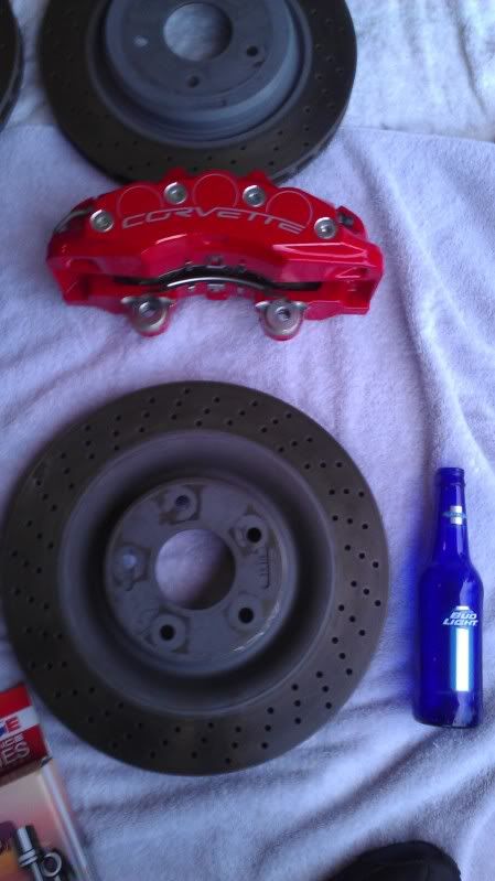

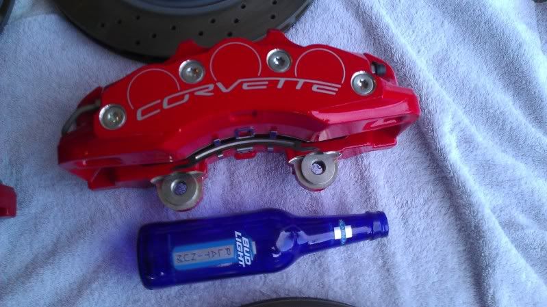

some new goods today. OMG the stock rotors are heavy. I will deff upgrade in the future.
  #74
Old 11-11-2012, 10:38 AM
Nice addition. Those will definitely stop you.

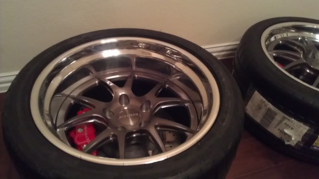

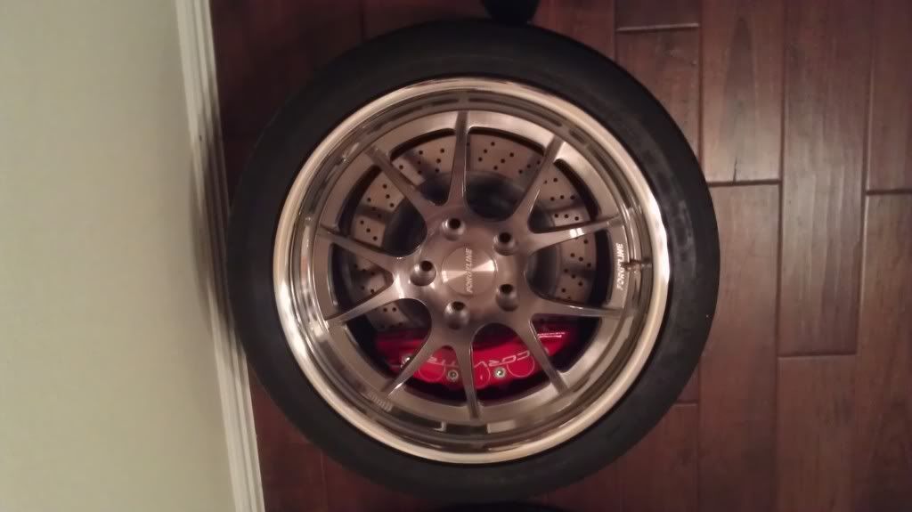

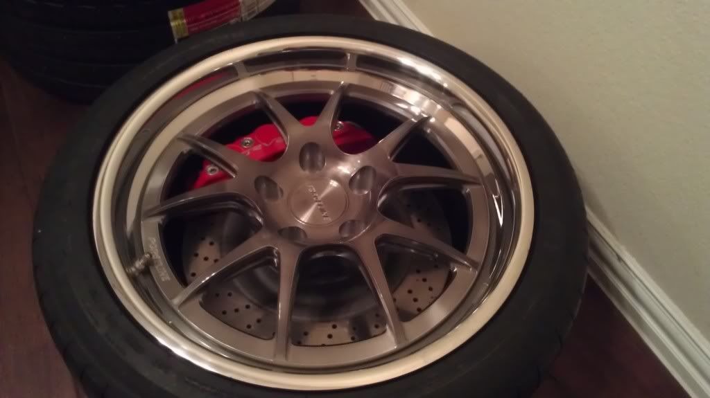

Pic do not do the wheels justice !!!!

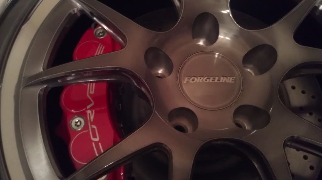

Next im going to slam the car and test for any and all clearance issues. I was told a 18x9.5 wouldnt fit on the front without rubbing. Well my fronts are 18x9.5 with 6.375 backspacing and the front very low there are no rubbing issues ")

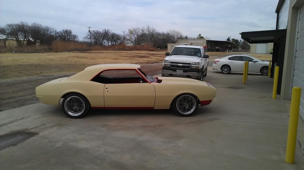

car is now lowered, rear end is set in the correct location, car is slammed to the ground and no rubbing issues at all. I pulled the front inner fenders just alittle and i have plenty of clearance. I know DSE wants you to run a 18x9 on the front but i went with 18x9.5 at 6.375 backspacing and its PERFECT !!!!
and i love this pic.
