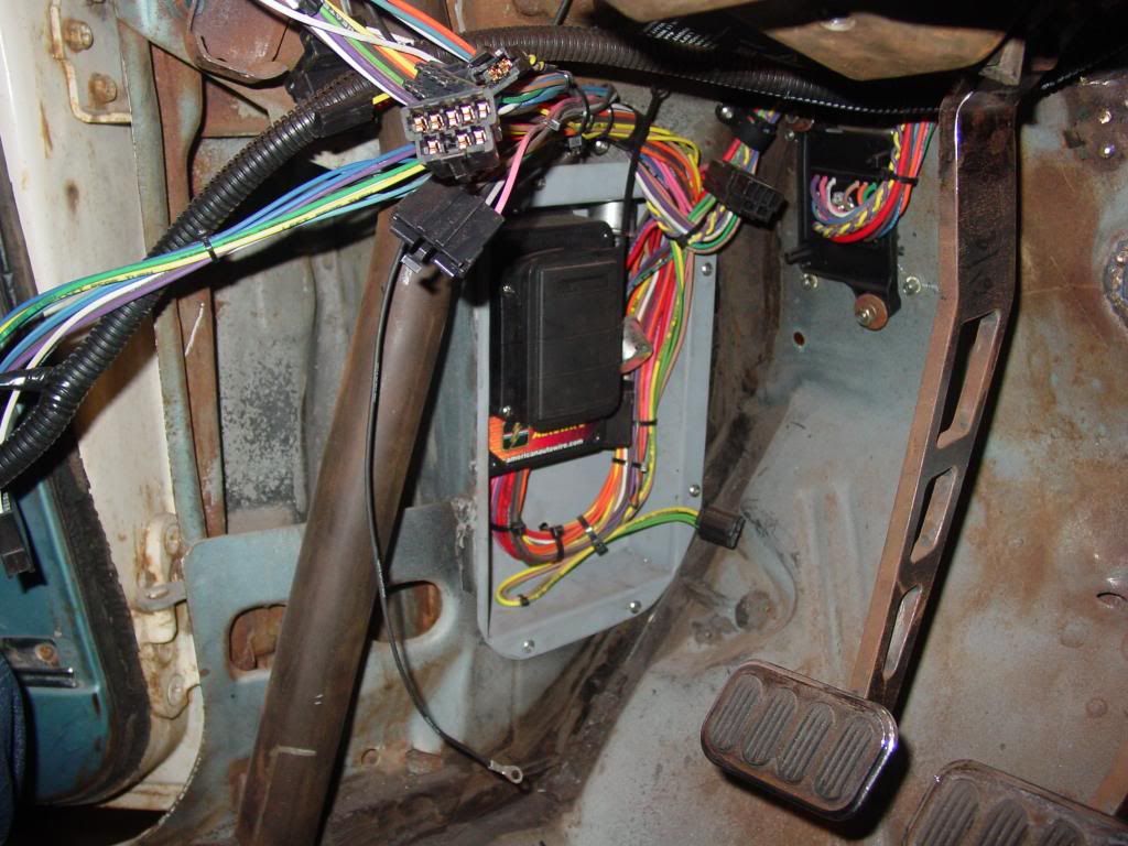

Mounted the AAW fuse block and wiring harness

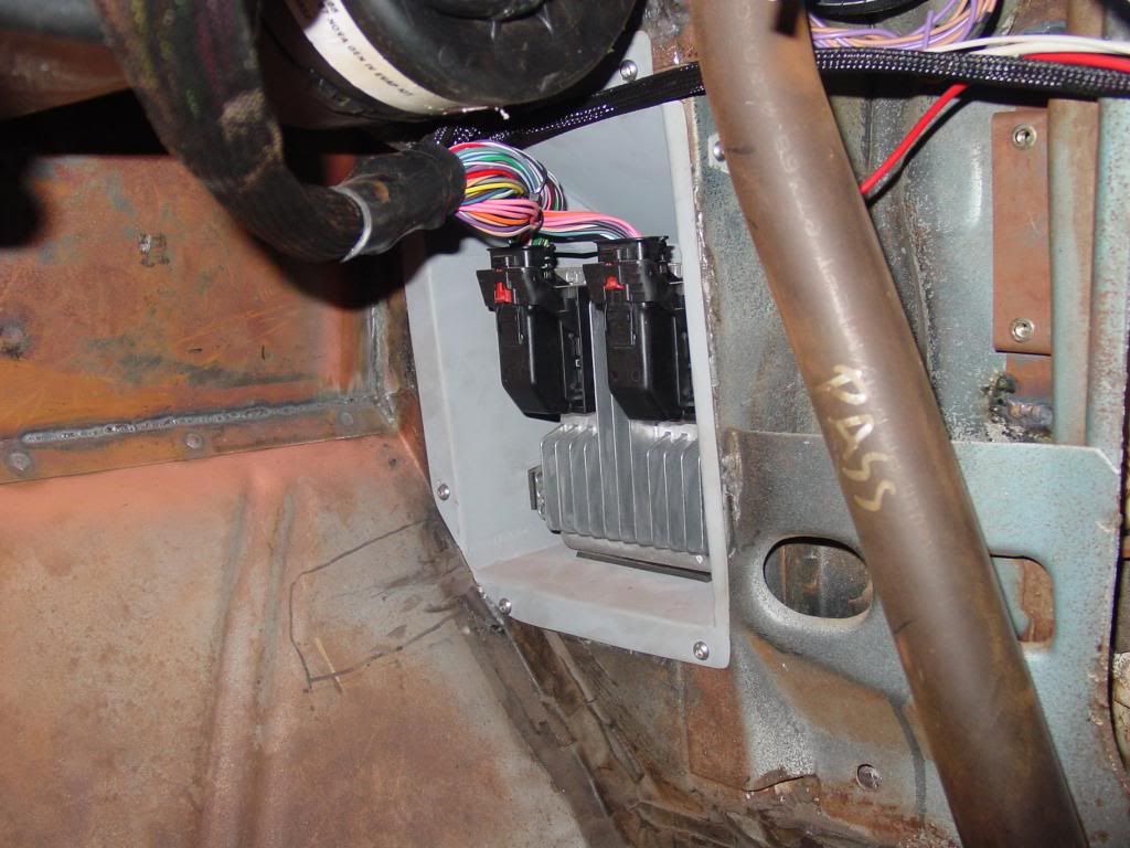

Did the same for the ECM

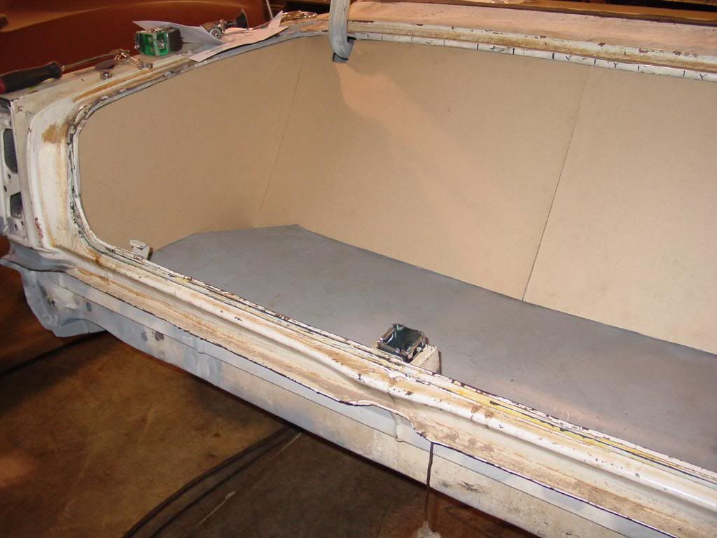

Got the panels made for the trunk. Showing some shape now.
Modo Innovations electric trunk latch installed. Very easy install and great product

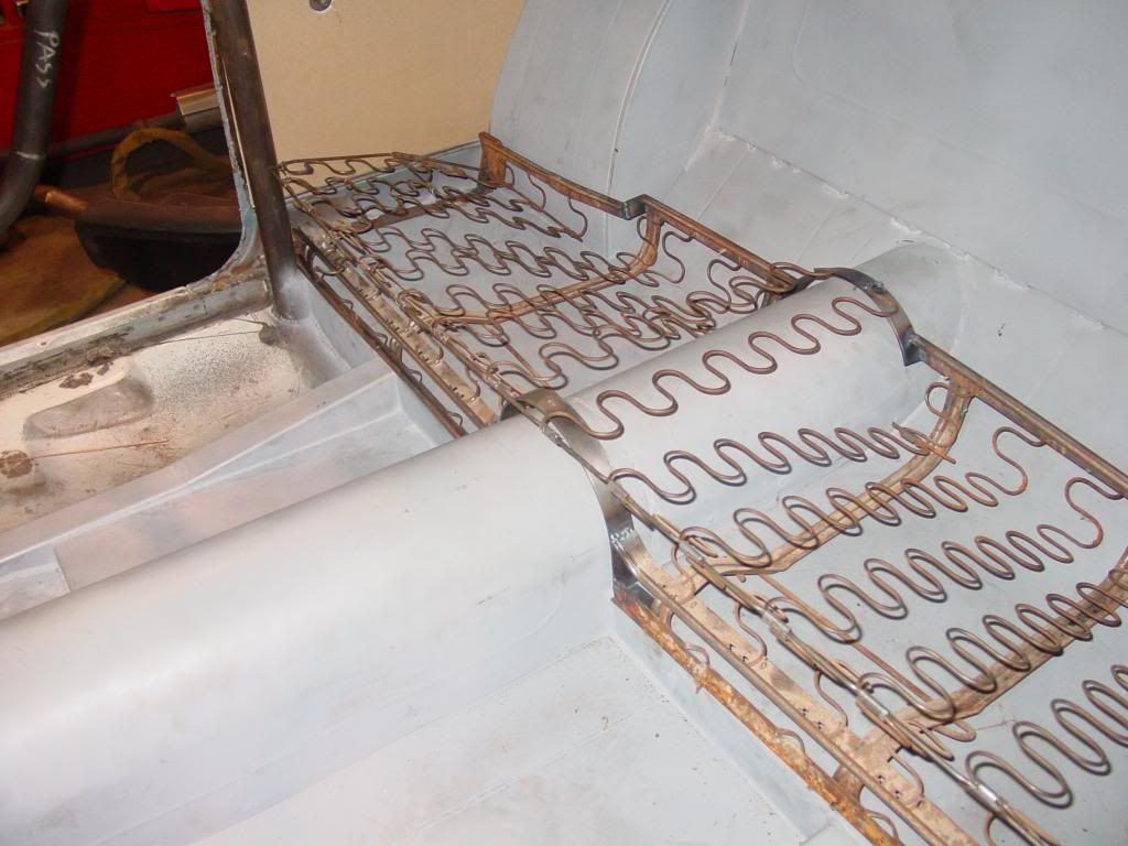

With a little cutting and welding, the stock seat frame fits. Turning the bench seat into bucket seats. If you look closely you can see the individual seats. The top of the seat is finished but my memory card filled up.

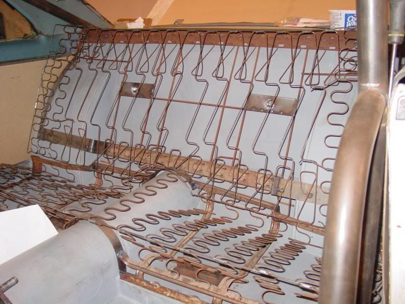

The mods to the rear seat are finished and it's mounted.

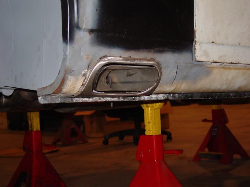

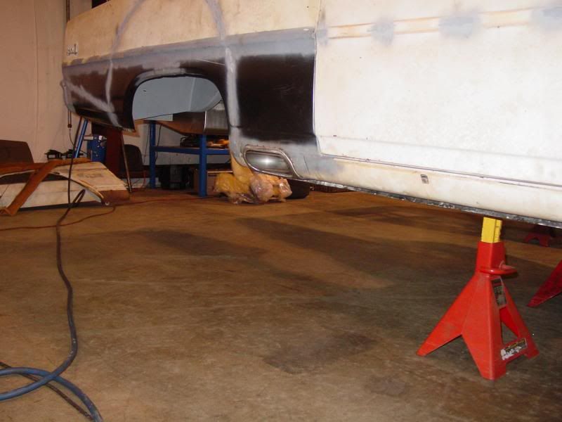

After months of decison making, the exhaust bezels are complete. I think they turned out good

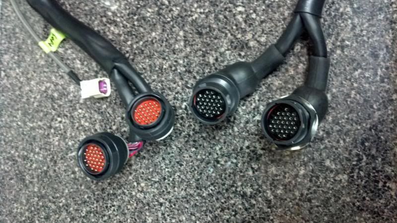

Scary when your new wiring harness looks like this!!! It's all back together now.

How much room did you give yourself for your exhaust? I've been thinking about doing something close to that on my falcon. I'm just concerned about the 3" exhaust getting too close to the tires. I don't need it causing issues on the big end of the strip!
