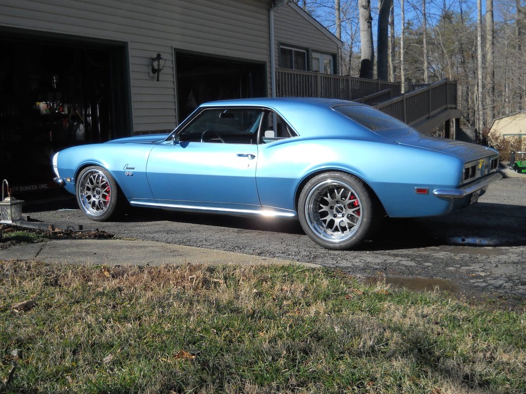

My Moser 9" floater is finished. I blead the brakes over the weekend. Total cost on the complete rear end including housing, hubs, axles, center section and brakes was just short of $2500.
looks great. what rear rotor is that? part number?
whats the WMS to WMS measurment?
Any pics of the caliper bracket?
Above Average Motorsports
1972 Nova, Ride Tech, Forgelines, Wilwood, Bowler Transmission, Lingenfelter, RAFT.
  #80
Old 01-24-2012, 05:13 PM
JasonElvisHeard JasonElvisHeard is offline
Join Date: Sep 2009
Posts: 132
TheJDMan - Looks good! Props to you for getting another thing checked off the list in your build, I really like your caliper / rotor selection as well. I'm a big fan of the Asymmetrical GT style rotors! Your car is really coming along.
