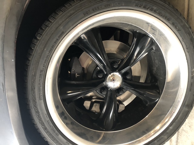

Caliper is mounted. It works perfectly with the one-touch window controller.

Im just about to finish my tesla install, I used a module to control the caliper similar to pantera's
I have installed only 1 tesla caliper....do you think this enough to hold the car from rolling?
1 is enough to hold my car firmly on a steep driveway. It very noticeable if I leave it engaged and try to drive away.
Did you use the Pantera controller or something else?
