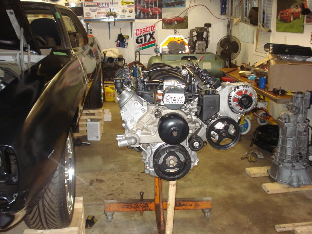

Originally Posted by jlwdvm View Post
Did you install mini-tubs to fit those tires? If not, what size/backspacing are you using?
Yes I did mini tub the car with a DSE kit.My rear rims are 18x12 and my back spacing is 6.125" Hope this helps

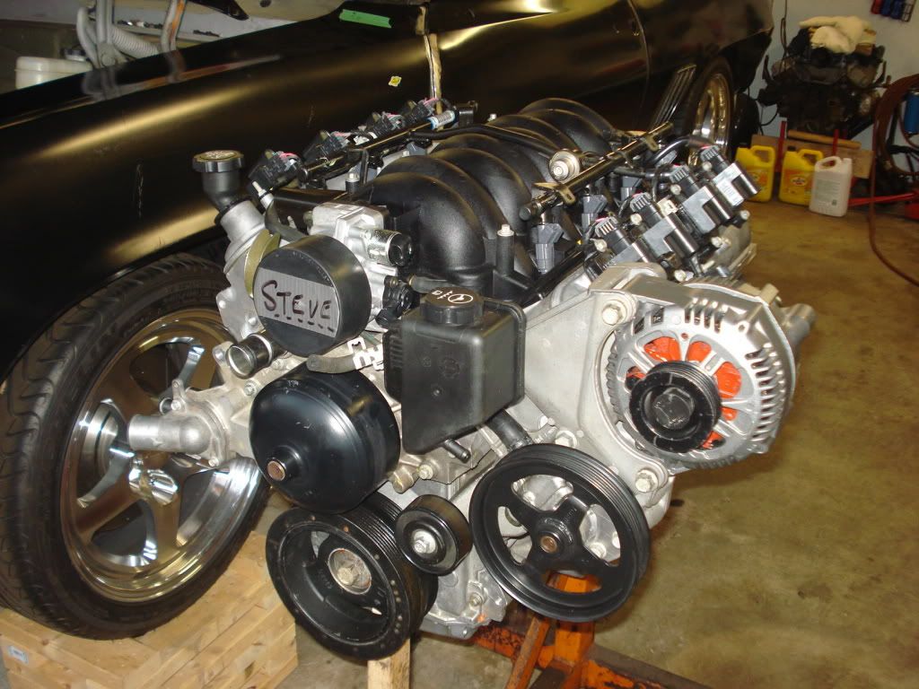

Originally Posted by Rybar View Post
Congrats on the new drivetrain. Is that an LS1 or LS6?? And what is the backspacing on your rear wheels? Car looks awesome keep us posted
Rybar the engine is a 2001 LS1 with LS6 intake,throttle body,camshaft and the valvetrain has been beefed to handle the LS6 cam lift.My rear rims are 18x12 with 6.125" backspacing.Hows your car coming???? I smell a mini tub coming?????
