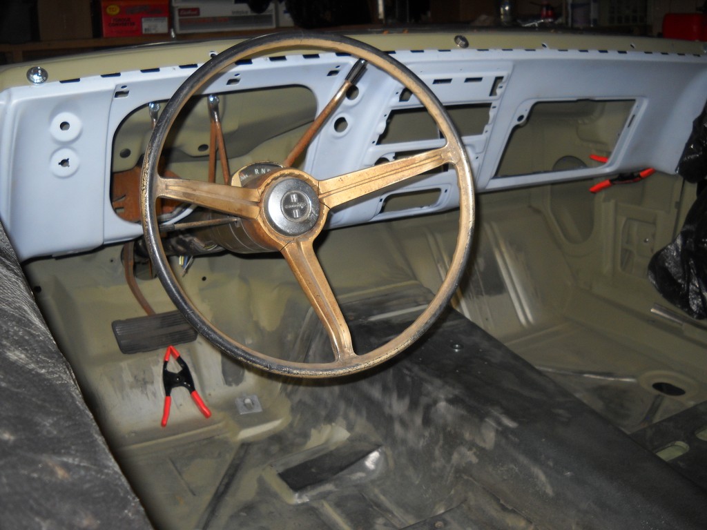

Finally warmed up here and I got the passenger side knuckle all bolted up and ready to go, still have to check toe and all that too!
So, my rack and pinion bracket came from Paul Horton's and thought I'd go see how it fit .... well 20 degrees change in the mounting plane changed the whole enchilada, not sure I need 20 degrees as I could take some of the angle off the plate.
I put all the dash and the steering wheel in to see how they line up ... hmmm, the angle of the dangle is off, is is too much? Take a look and advise, I looked at the Stielow Bible for reference, gonna need a different column fer sure.
Angle of the dangle is off, hmmmm ...
New bracket set in place fer now.
Drivers side setting there, may be too high!
20 degrees changed the plane alot!
Another view of the clearacnce.
Top down pix looks ok ....
It's looking like an interior of a Camaro!
Change one thing and you have to fix two other things .... that's hot rodding! I know I have to keep the CL of the pinion where is was to keep bump steer to a minimum, is there any thing else I need to check before I change to these mounts?

If you cut the column flange off then weld & bolt a short pc of double D shaft in the end of the column it will give you more room the straighten the angle of the steering shaft out.Then grind some of back side of the paul hortons mount plates and you should be go to go.

You should be able to use your stock column without cutting it up. I used the flange adaptor from here: http://www.cachassisworks.com/c-1040...omponents.aspx
Then a standard U-joint down on the rack and it should clear. My rack is also tilted, but maybe not as far as yours. I'm using a Ford Thunder SC power rack.

Scott ... that's why I referenced Stielow's bible, good pixs! Still weighing the cost and benefits of all this!
That there is a good idea .... that's why I have my Camaro on this site, great people to share ideas with
