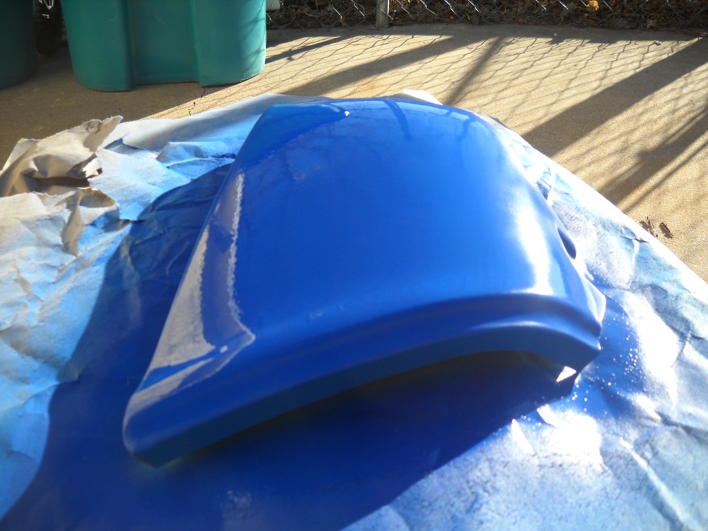

So, since its so nice out I figured I'd spray some color and narrow down a color choice .... not an easy task fer sure.
Anyway, here is a matte blue that is interesting, I might try a grey also ...
The extension was not body shaped, just in primer, the dent will buff out
JUST PICTUREShttps://imageshack.com/user/mcavery

What dent?
hehe
Man, can't believe the progress you have been making. It is always good to switch channels and do some painting to kind of unwind after being neck deep in fabbing, and other demanding parts of a project.

Well, picked a couple more colors today and sprayed the extension again ... the grey is alright but the blackblue may be the ticket.

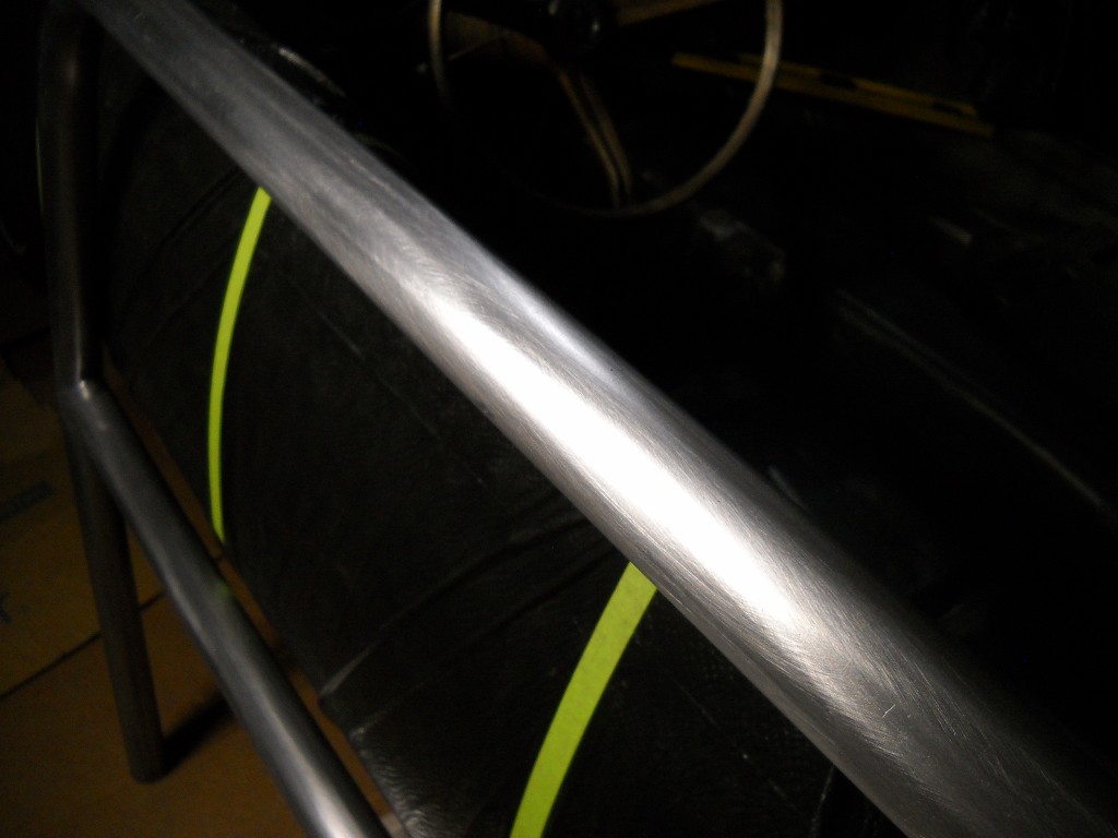

Got the roof off, fabbed up the floor plates, cleaned all the mill scale and rust off the roll bars ... looks kick azz in brushed, may just clear over this!!

Looks like you need to buzz a hole shut by the subframe connector Chief?
Great work as usual. I think you need a few more parts to spray so you can give yourself an assortment to view. I think I like the medium blue but normally those hues are not my favorite blues. Rhyme unintended.
Like Track Rat, the color may be an exception on a car as impressive as yours will be. I didn't think I would like Makita blue on Track Rat but it works.
That said, the Midnight blue could be cool especially with a stripe.
