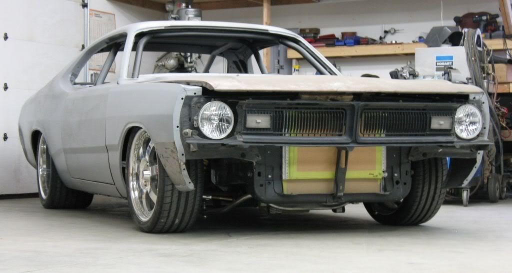

Thought I'd post my project......I dig this site
71 Dodge Demon
AlterKtion front suspension (QA1 coil overs)
Power rackNpinion
Wilwood Discs (12.2") all fours
Subframe connnectors
Custom roll cage
Tri-4 bar (Varishock coil overs)
Mini tubbed
Whole car was blasted and coated in DP90, and panel/rough body work done
Engine-6.1 hemi
Stock for now
Transmission
Paddle shifted 4l60E
Rear 8 3/4-done
3.55 suregrip
Tires/Wheels...255/35/18's 345/30/19's, Intro ID luxury 301's
Corbeau seats
Rocky Mountain Dash....aluminum w/ Autometer gauges
Ididit column
Vintage Air GenII
Smoothed/Shaved---firewall, inner fenders, core support, drip rails, marker lights, trunk lock, door handles are shaved til I decide on a set
Project has been done in my home shop and been to a couple of pro's......been issues w/ one of them, so I pulled the car
Bruning Auto Design renewed my interest in it........great attention to detail
I know everyone likes pics...........thanks Rob
