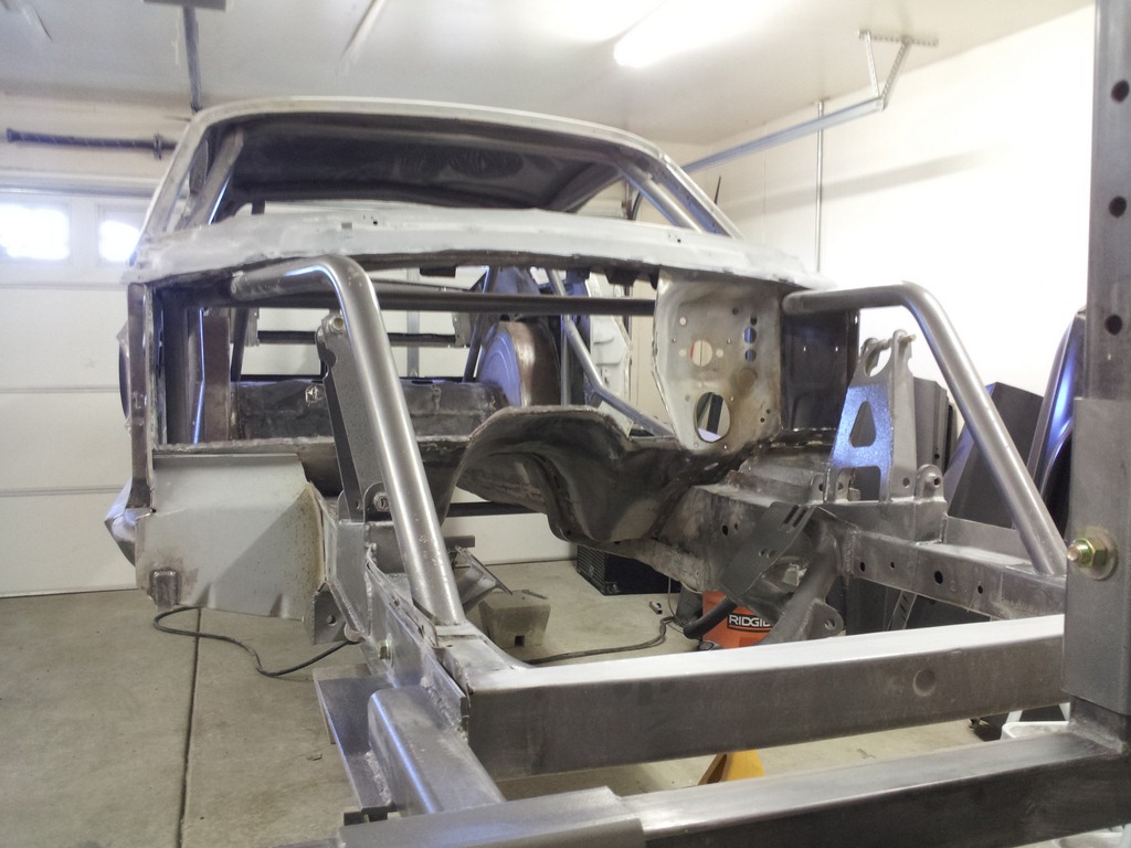

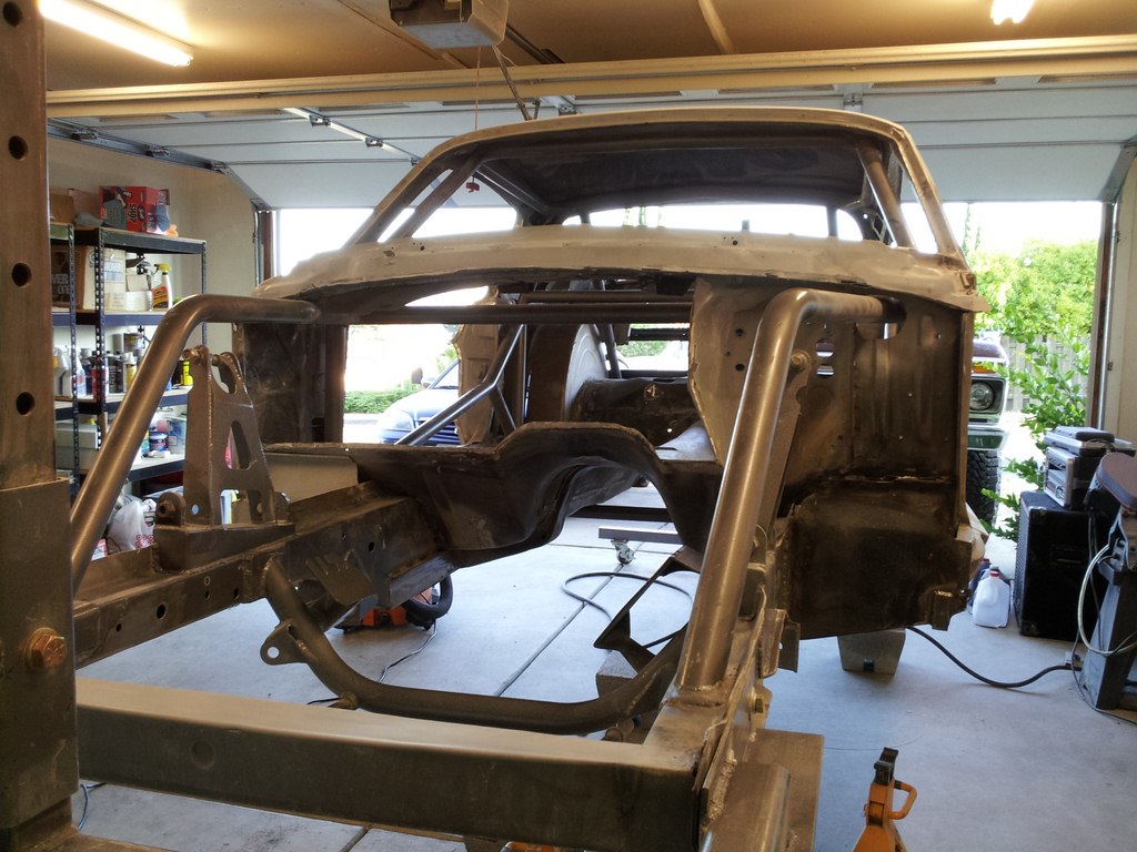

Thanks!! After adding a torque box on the passenger side, sub-frame connectors, 8 point cage, seam welding the entire chassis and rocker rail support kit I think its fair to say that the chassis is a lot stronger!!
Plenty of strength there for sure. It looks great. Nice work.

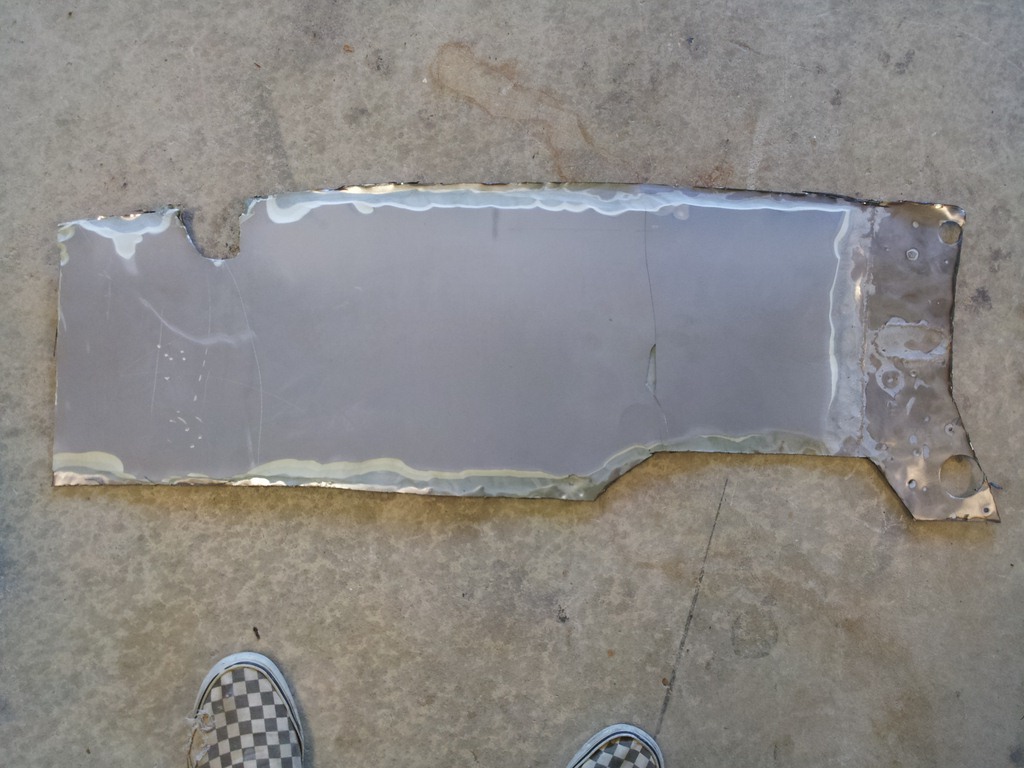

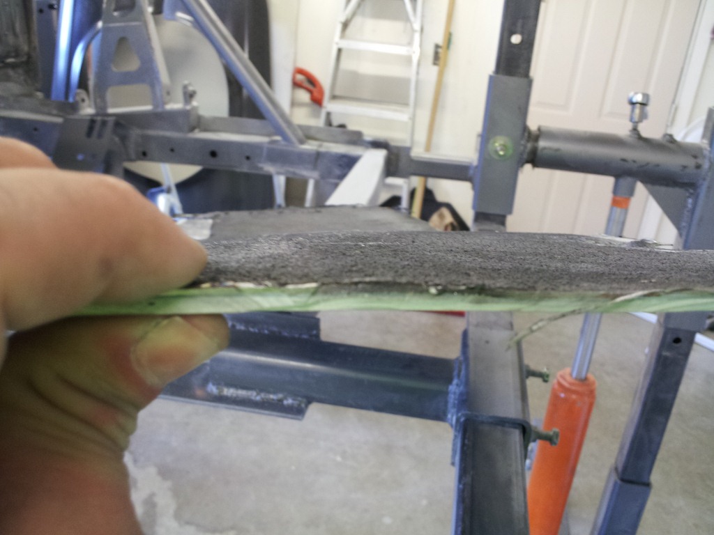

There is officially NO body filler on my car!! Cut out the previous bad work on the firewall today. Body filler was 3/8 thick or more in some areas WTF!! In pics 4 and 5 you can see how wavy and warped the sheet metal was. Seems like the body shop bowed the sheet metal inward so they could fill it with body filler. I cant believe the work some people do.

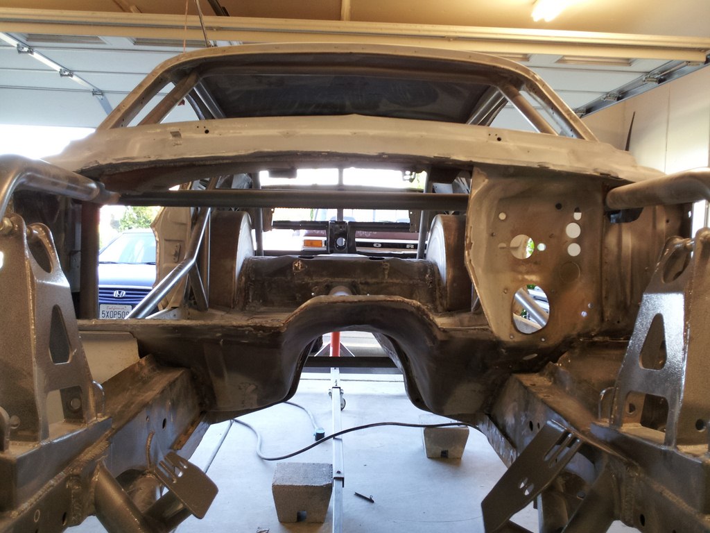

Not sure if I should cut out the factory recessed area from the firewall?? What do you guys think??

any holes gona be reused in the same place?
also good to see that you found work. nice project

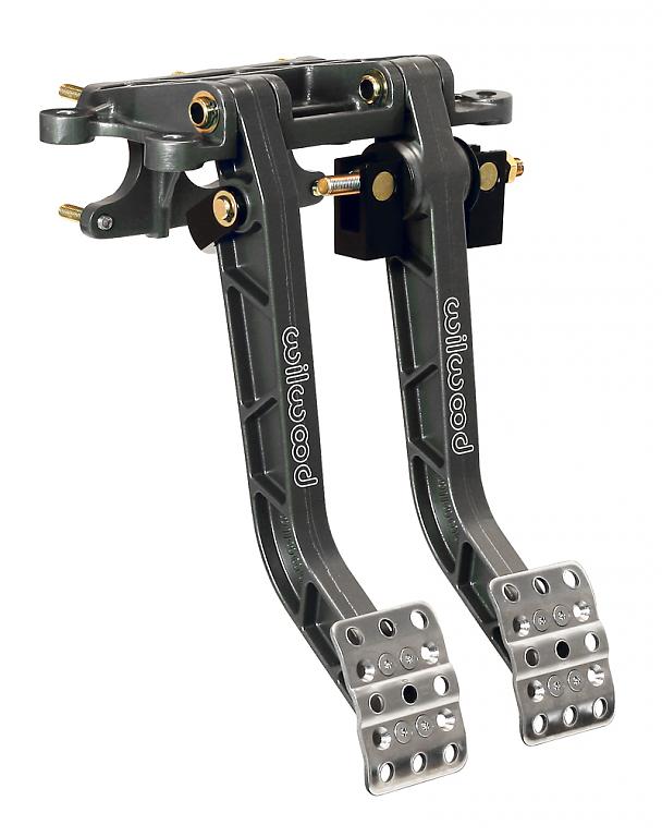

Thanks for the feedback!! I was going to use the stock pedals and steering column, but now I'm leaning more towards Wilwoods new pedal assembly. I'm just going bite the bullet and cut out the recessed area out. I guess since everything else is custom on the car why not keep the trend going!!! Now I need to find a sugar mama and I will be set

That is a nice pedal assembly .

Those pedals are fantastic! I will be ordering mine once i get the dash put back in to see how long of a pedal im going to need and room im going to have
I removed the recessed area of the firewall and the bulbous portion that houses the heater box. That changed the look of entire engine bay and opened a lot of room on the drivers side.
The aftermarket AC system fits well.

Most of the chassis fab is done just need to clean some things up. I will focus more on hanging the doors and fenders. Fenders will be tricky since I need to design and fab up the inner fender structure. I will also try to figure out a core support design.
