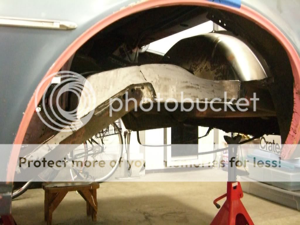

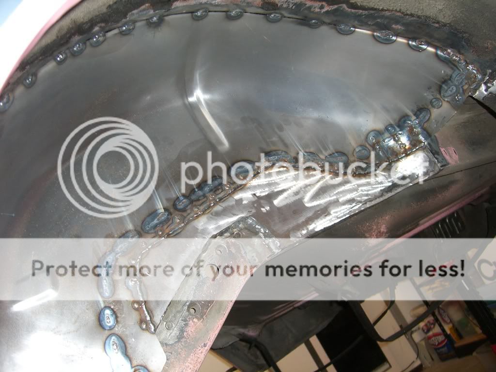

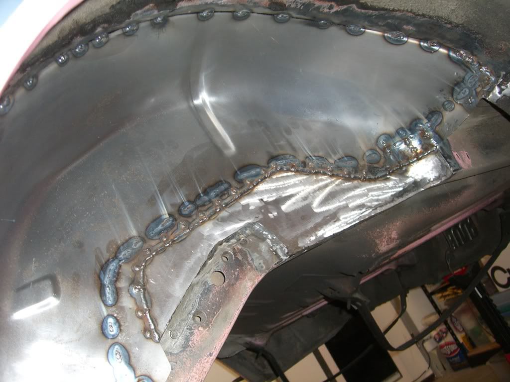

I have the fill plates on the drivers side complete.
Still working on the passenger side. Nothing happened tonight. I decided to make a really nice lobster/scallop risotto for my wife tonight. BTW, Girgich Cellars Chardonnay.....get some.

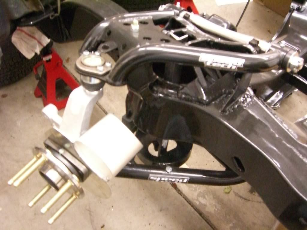

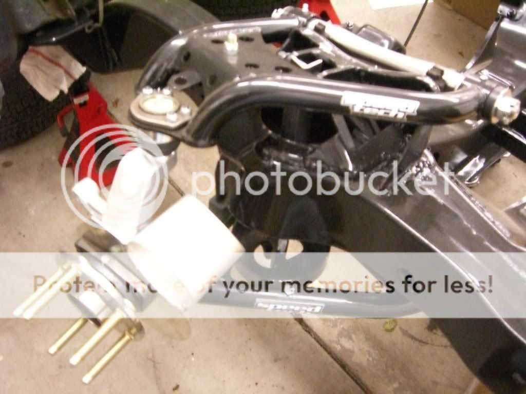

Front suspension coming together....
ATS spindle
Speed-Tech Upper/Lower Control Arms
LG Motorsports brake backing plate
$2.00 worth of angle iron from Lowes pretending to be a shock absorber

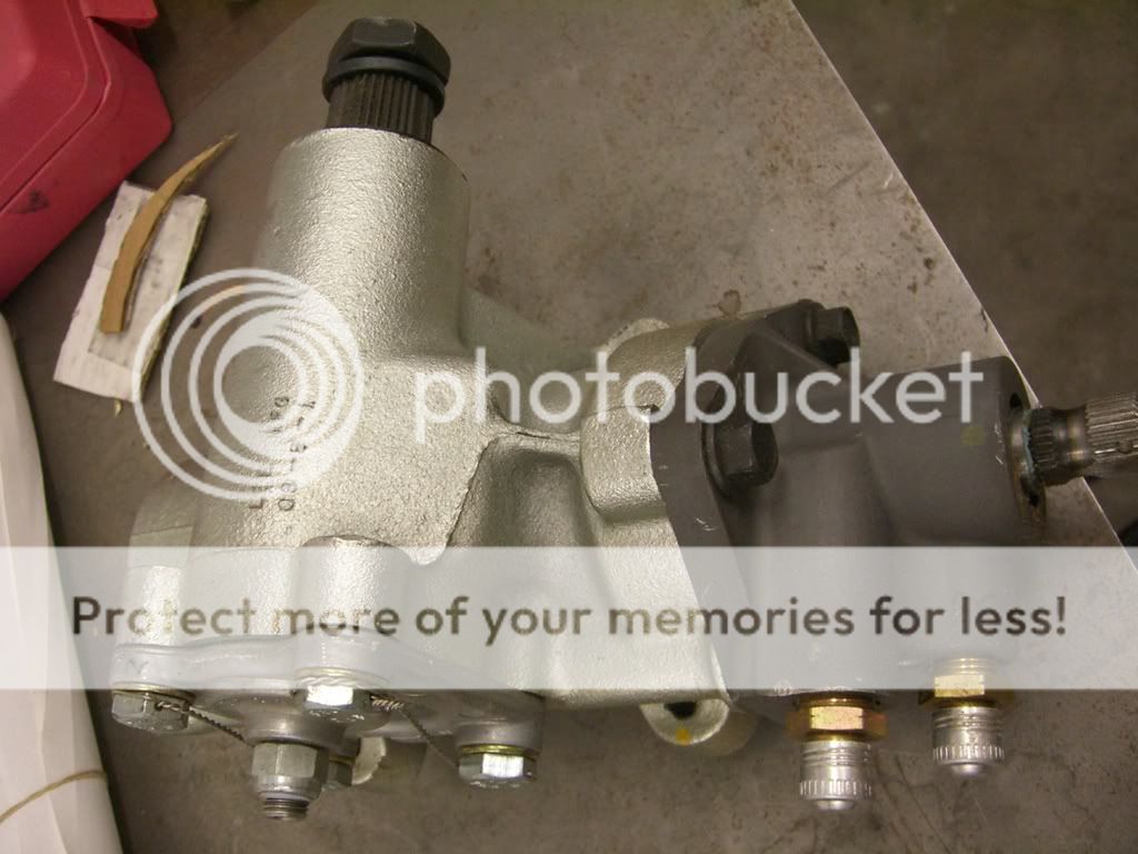

ATS/Lee Manufacturing Steering gear:
I know, I know...the nice cad plating.....CA EPA said Lee can't use the stuff anymore.....freakin hippies.

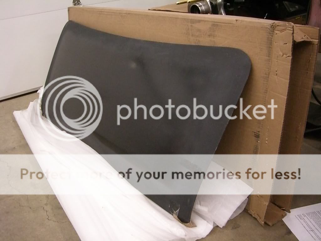

Something light and itchy and strangely similar to a decklid

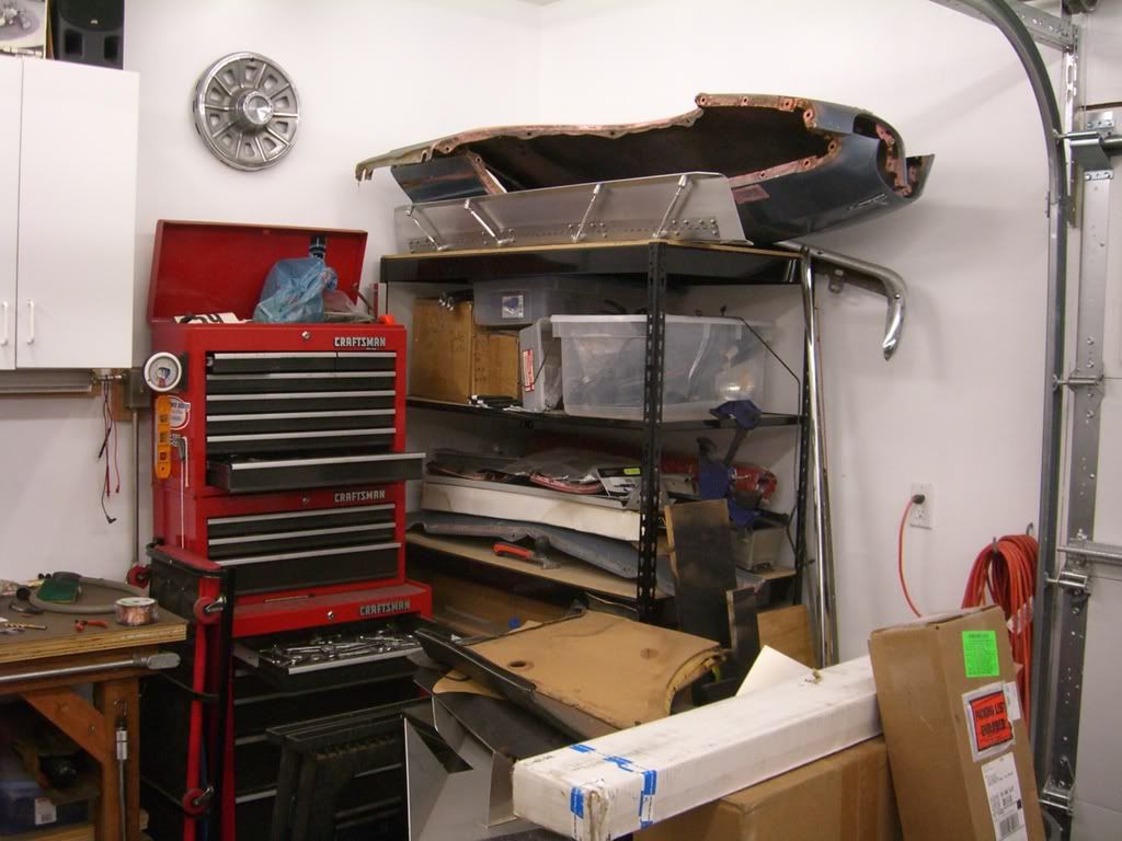

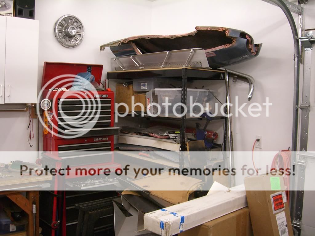

One of my favorites up there on the top shelf......The Twist-Machine / Jakes Rod Shop rear spoiler. That thing makes me tingle in my special place.

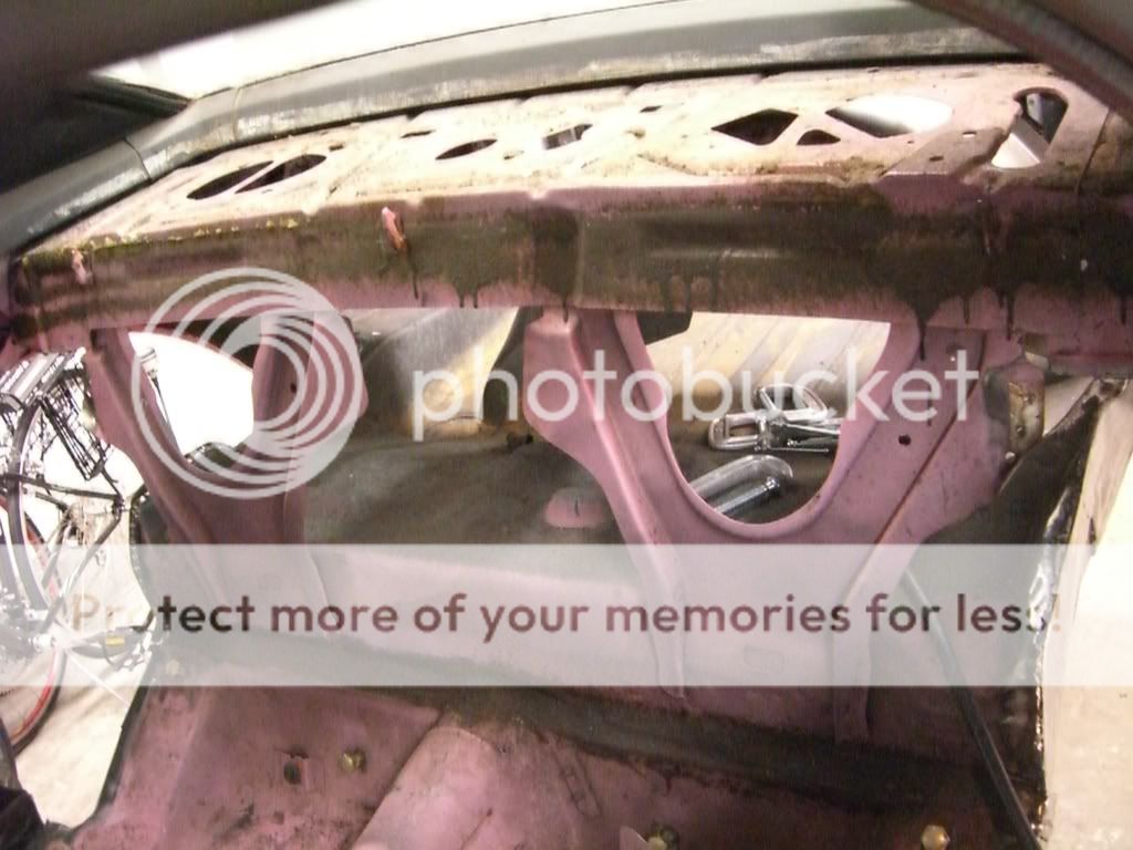

One of my next projects is to create a bulkhead out of all of these holes. Haven't decided if I want to weld a bit of metal into each of those openings, or just cover the whole thing up with a couple of sheets bent to fit. Suggestions?

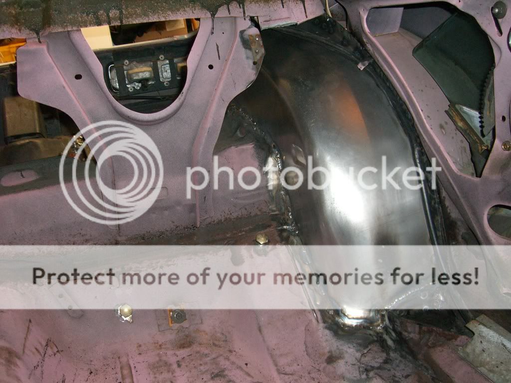

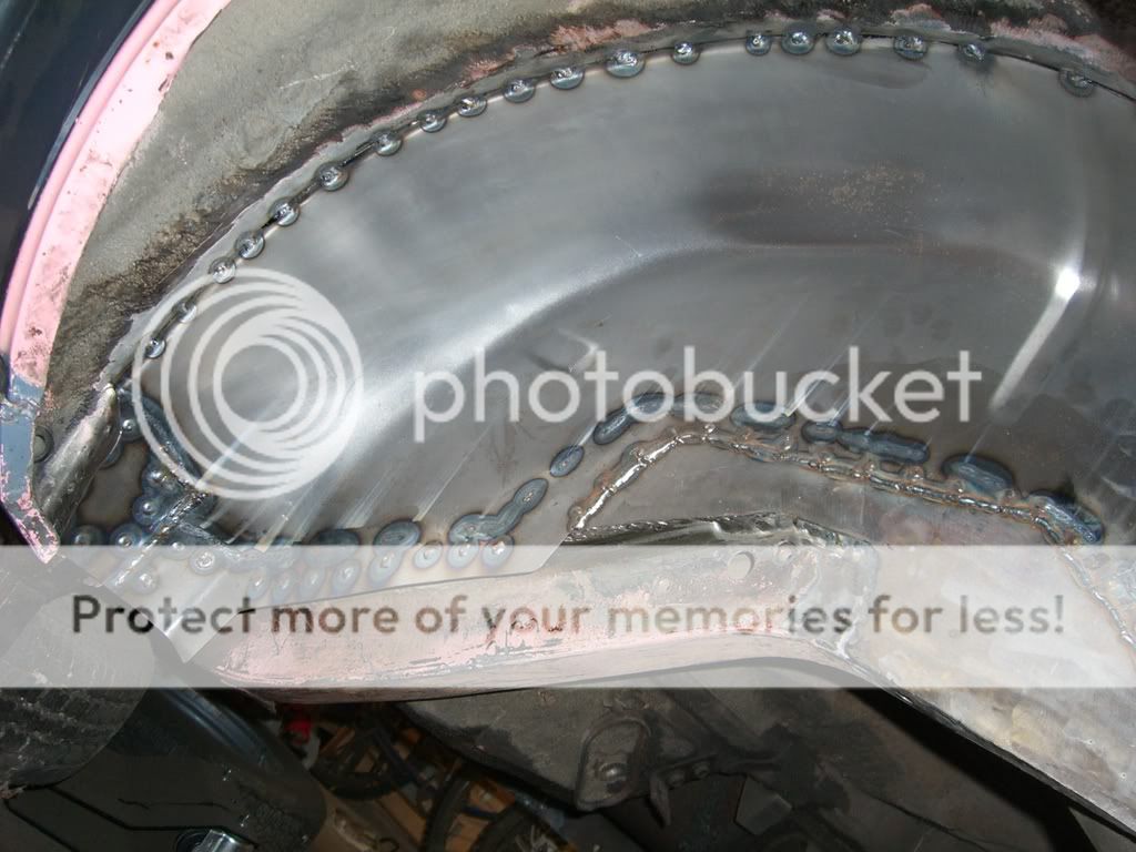

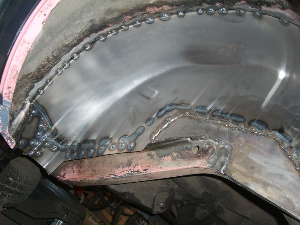

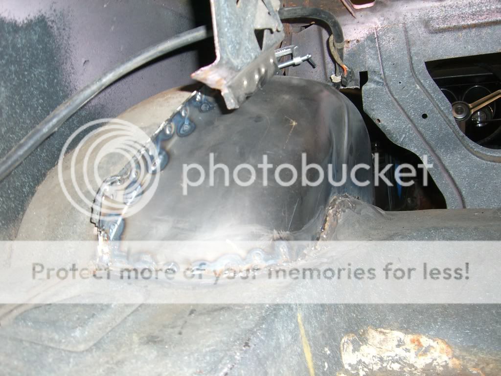

Well the drivers side tub is all but finished. Just need to grind the welds down a bit, close over that flap on the lower forward bit and hit it with the seam sealer.
I have a quart of seam sealer from Eastwood, but I'm wondering if it might be better to use a different product that is more of a caulk type. Any thoughts?

A caulk type seam sealer might be easier to put in that inner to outer wheelhouse seam.

Any good seam sealer would do, but the tube type that goes into your caulking gun would be easier to apply and force into the gap. Just be sure the degrease the bare steel and shoot it with some type of etch prime to avoid future rust before you apply the seam sealer.
