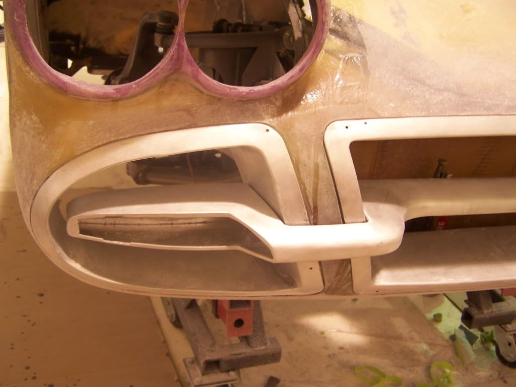

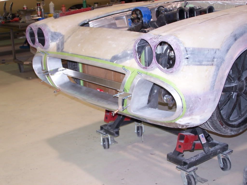

Here ae a few more pics of the re-worked front end. We tossed all of the stock trim and grilles. complete new units were fabricated from aluminum to change the shape of the openings and give it a more modern, aggressive look.
Center grille opening
Here, the center opening has already been fabbed. The passenger side blank was hammered out as a solid piece. The center was blacked out to show where it will be trimmed away for the opening.
Starting to mock up center grille bar.

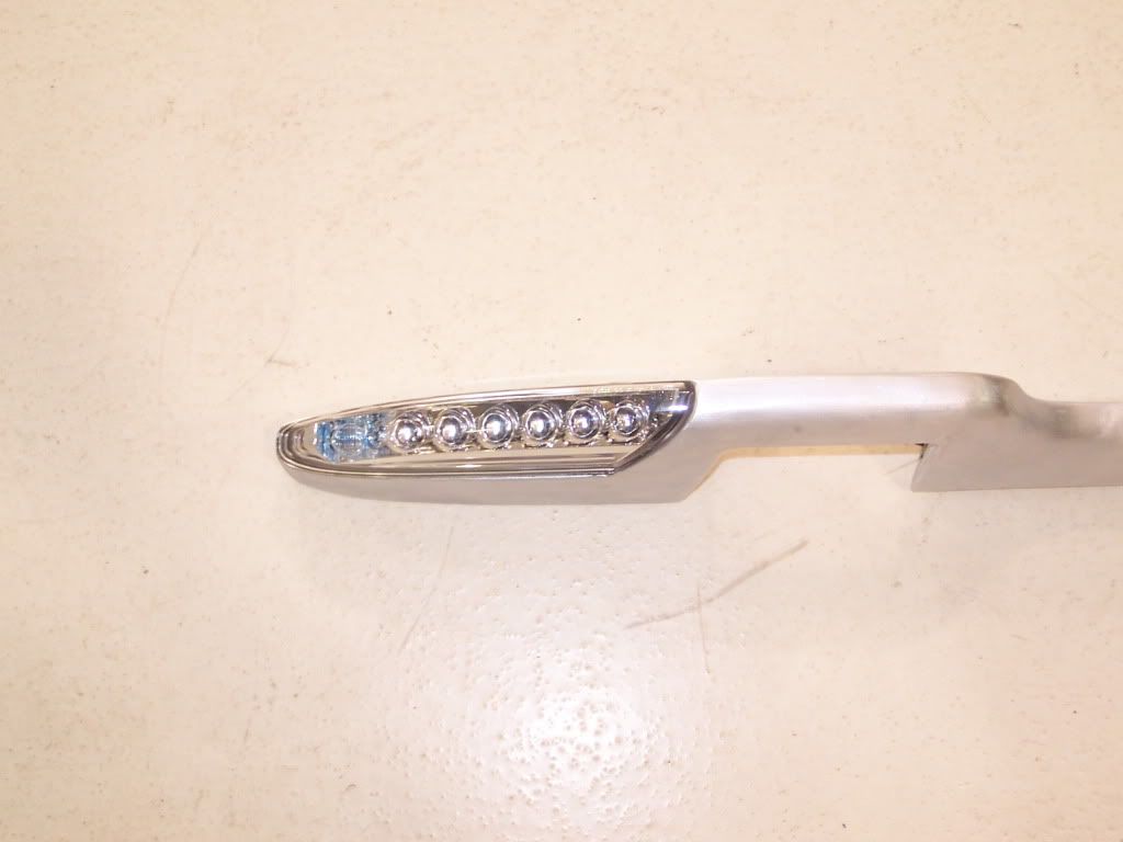

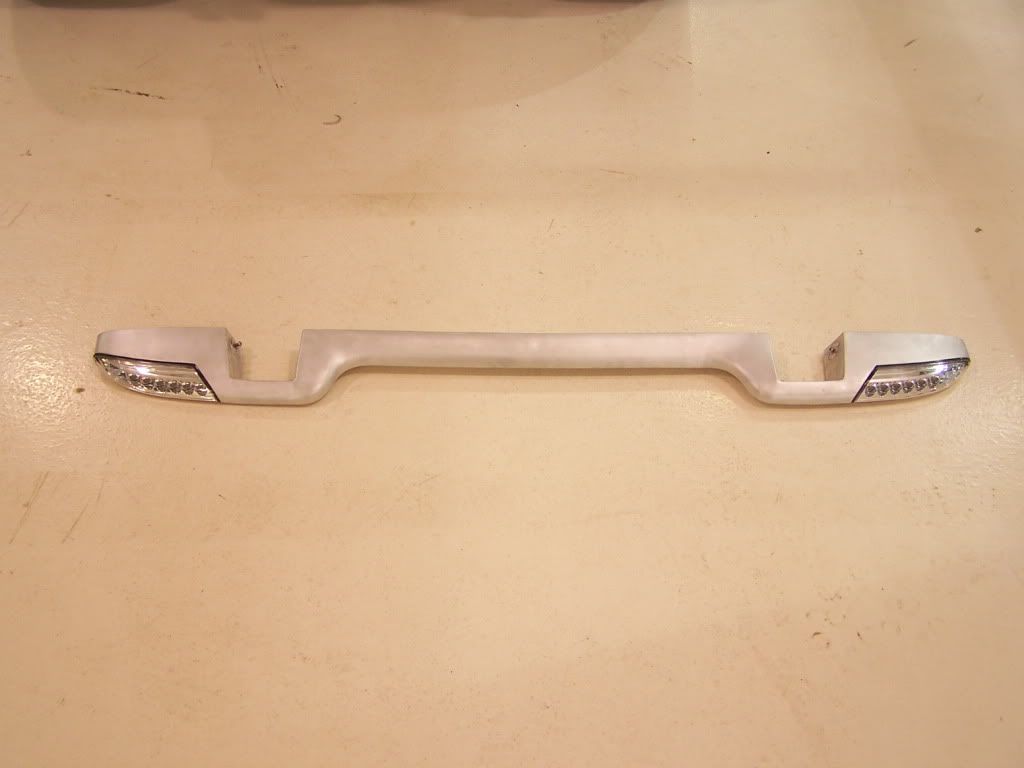

Aluminum grille bar

And here is the difference compared to stock.
