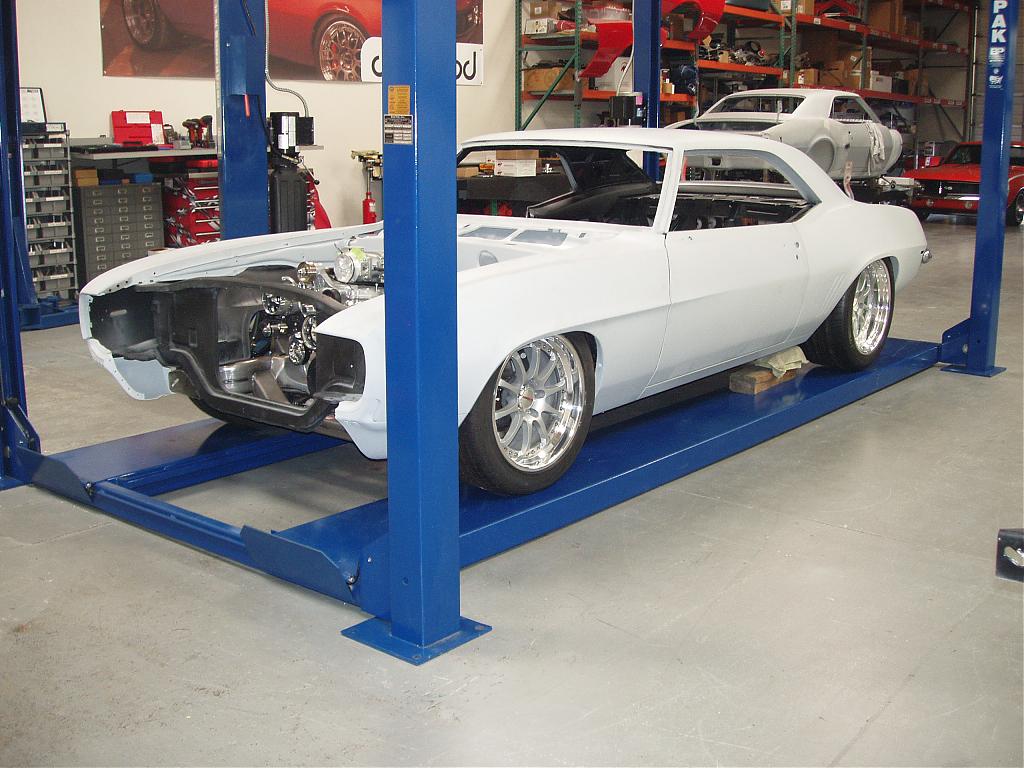

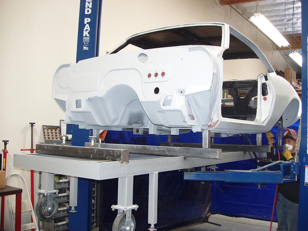

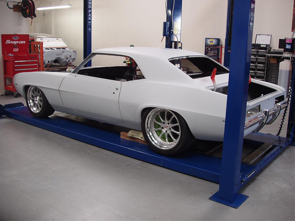

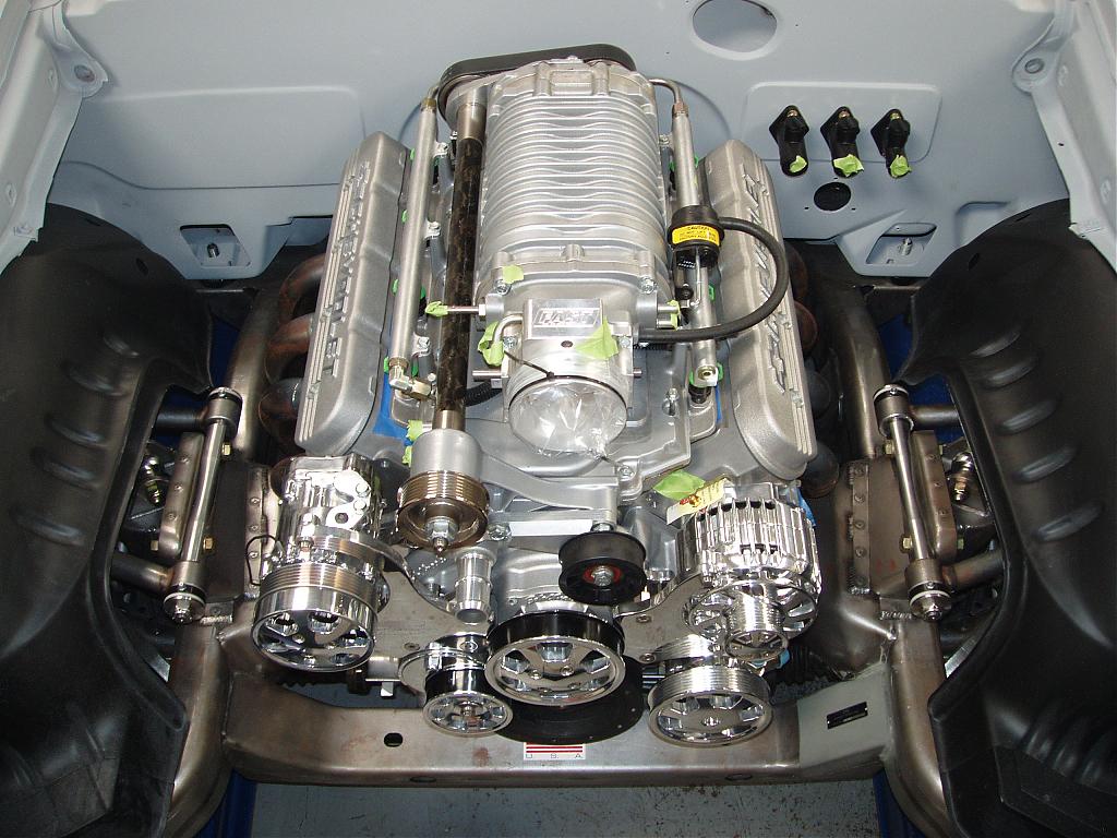

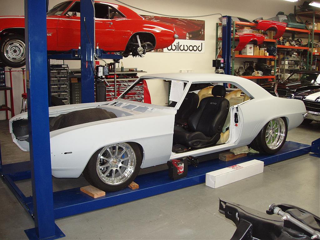

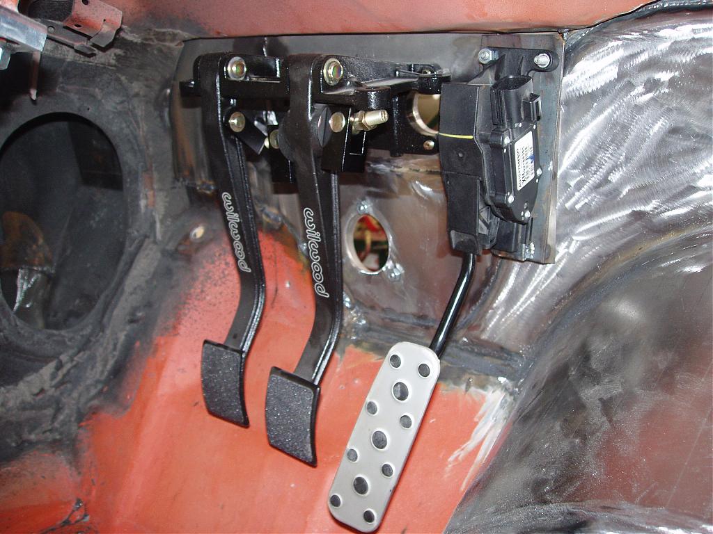

Default JCG Restoration & Customs 69 build
Introducting my current build to Lateral-G.. 69 Z28 Camaro
LS7 with Magnacharger
T56 6 speed
Detroit Speed subframe
Chassisworks G-bar rear suspension
Marquez Interior pcs
Car currently @ plumbing with Bent Custom & performance!!

Wheels are Forgeline & tire size on rear 345 30 19 with 255 35 19 in the front.. We stretched the rear qtrs about 2 inches with mini tub..

When you say stretched, is that stretched outward, or did you make the actual wheel opening 2" bigger?
Ever put that tire on a 67/68?
Any updates on the car? It's killer..

It is stretched 2 inches out which gives the car a wider look..
Yes.. You can run 345-30-19 with a fender stretch & mini-tub on 67/68
The car has been back with owner for some time now with addiational changes made to it.. Palmer Customs has taken over the project with the owner for final finish on it..

Sweet project! I dig the rear bumper guards.
