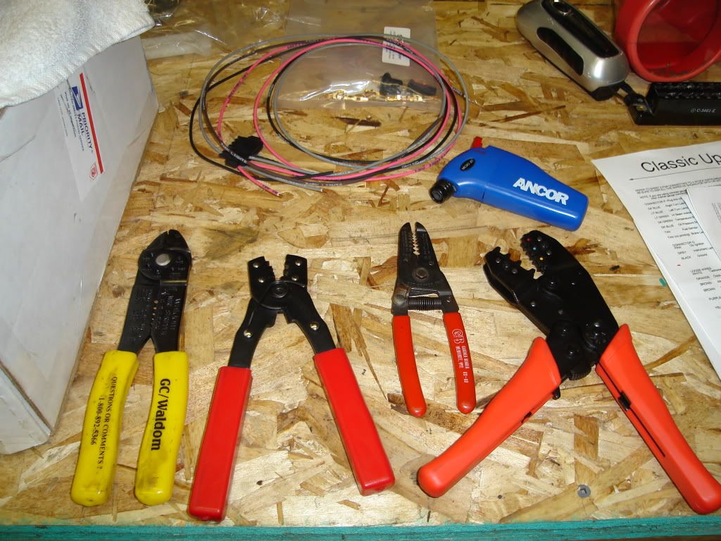

American Auto Wire was nice enough to mail me some wire connectors so I could wire my guage plug ends directly into their bulk head.
Wiring almost complete.
These are most of the tools that I needed to complete the job.

I'm not very far into the wiring yet but it seems like a pretty good kit. The only thing that I'm not crazy about is using splice connectors to hook up all of the tail light sockets. I might put on terminal ends and then stagger them so I can hide them in the wiring harness cover. I'm not that far yet so I'm sure I will be asking some questions real soon. The only fit issue I have had so far is the emergency brake switch hits the fuse block. I need to oblong out the holes in the firewall a little to slide it over. Or I might just tweak the bracket a little. Overall it seems to be a very complete kit.

Have you thought about soldering & heat shrink over the connections? It would give you a longer lasting/better connection and also hide easier than bulky connectors.
Just a thought. Soldering all those can't be any fun at all. Lol

I would prefer to not have to solder every connection. I'm not a huge fan of soldering either. Every wire in the AAW kit is crimped along with most newer cars now days. Now I'm not trying to start a debate over which is better. Because I'm not sure which is better.
I think they both have their place and location where they both are needed. With that being said I'm not sure what I'm going to do yet. I think a friend of mine has some soderless connections that have shrink tubing built into them. That might also be an option.

I only meant that solder joints would hide easier in the wrap. If they crimp everything anyway, I am sure that method is fine.

You haven't seen my solder joints then
Maybe I will give it a try again. I might need to buy a new solderding gun. (smaller) The huge Craftsman one that I have will give your bicep a workout after a few connections.
