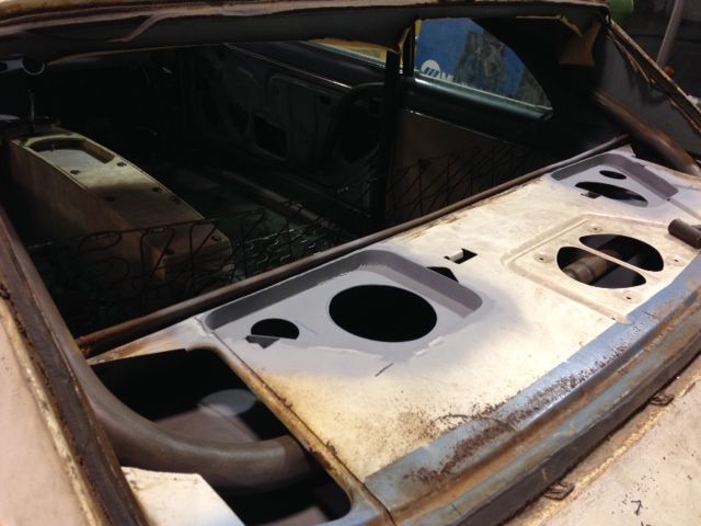

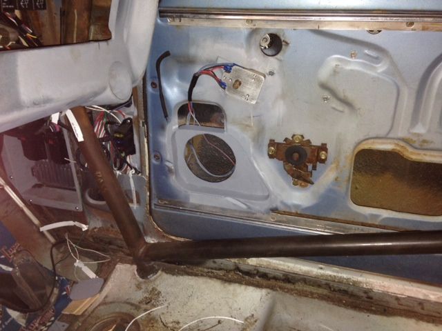

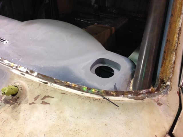

I have not been around for quite a few months, I have a ton of updates but only a few pics. Sorry! The 3 I have are the package tray speaker mounts, door speaker mounts, and the tweeter mounts in the dash. I recessed them so that the speaker grills I am building will be flush mounted with the interior. Since I posted last, all of the fuel/brake lines are finished and mounted securely, finished the center console, and working on the air intake/filter mount right now. The car will be ready for body work around Jan. 1. Then the fun begins.
You get a peek at the center console in the last 2 pics.
