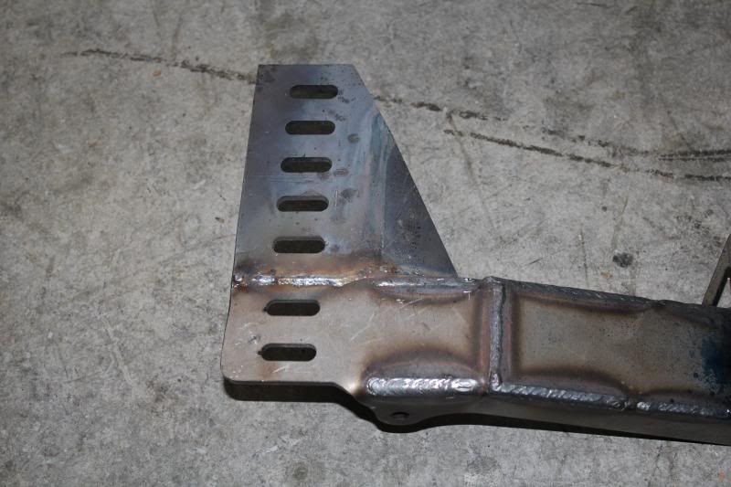

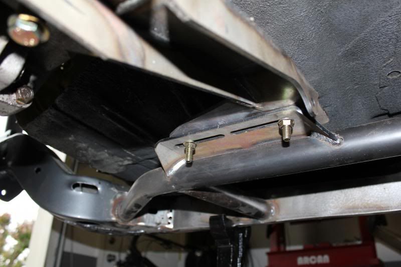

So here is what I have been up to the last couple of days. I had to modify the HPI trans mount. It wouldn't let me slide the engine back where I wanted it at. Tyler was very helpful, send a couple of tube mounts for me to use, but I decided to go a different route. Had some metal cutout and I added it to the crossmember.
Of course, I had to do both sides.
Now it fits in there better.
It spreads the load over the side brackets better.
HEEP

Looking really good! I like the crossmember mods. I would think that the longer mounting tabs would cut down on twisting, but I'm not an engineer.
