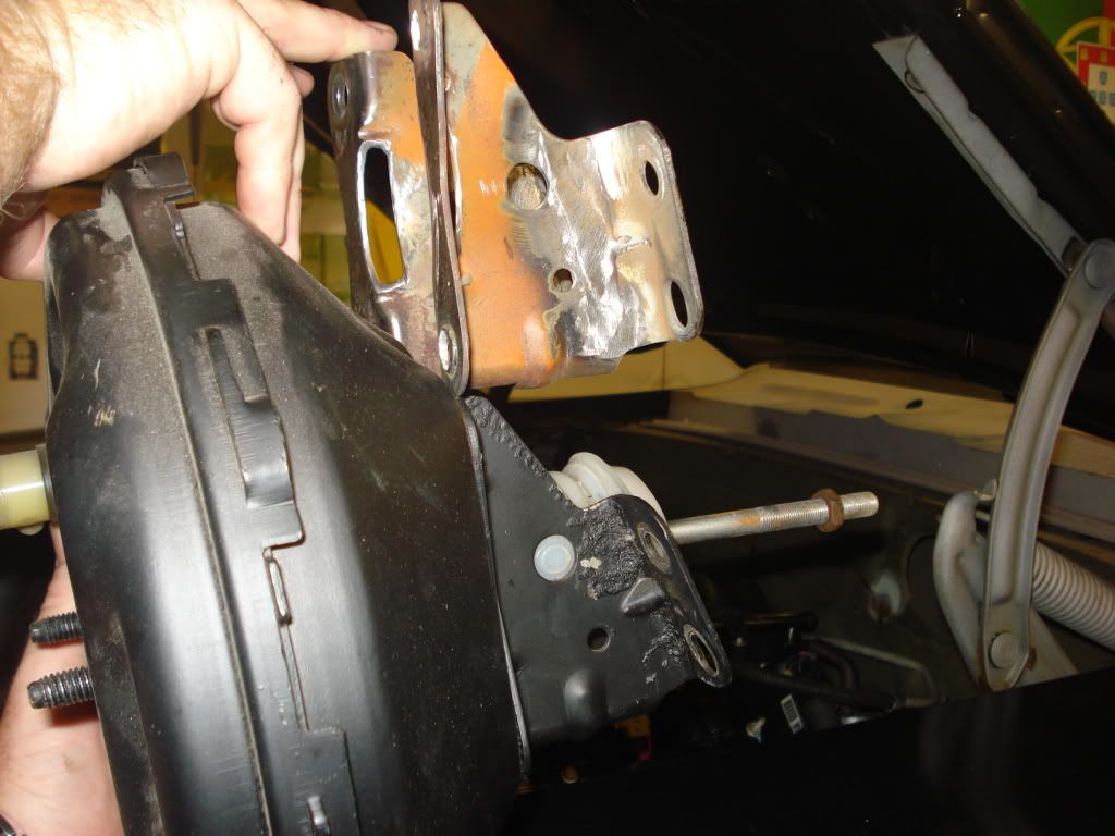

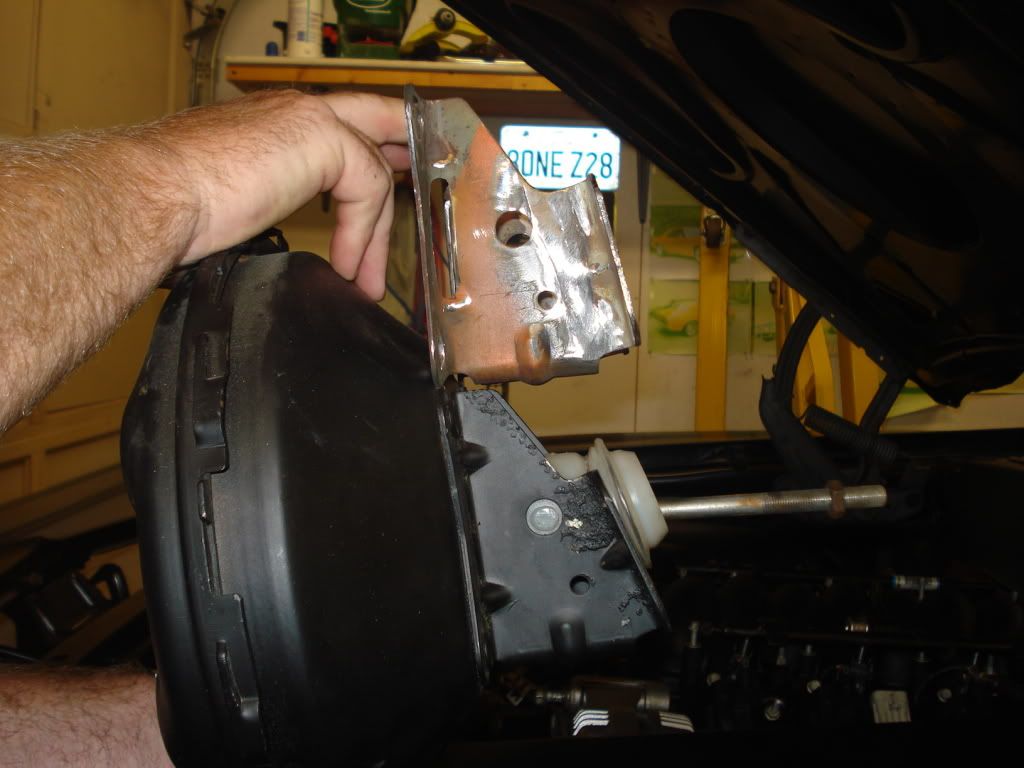

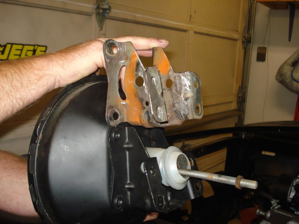

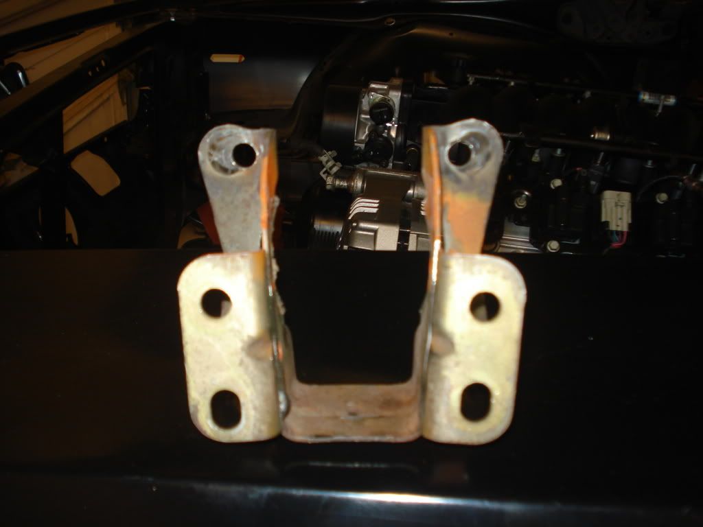

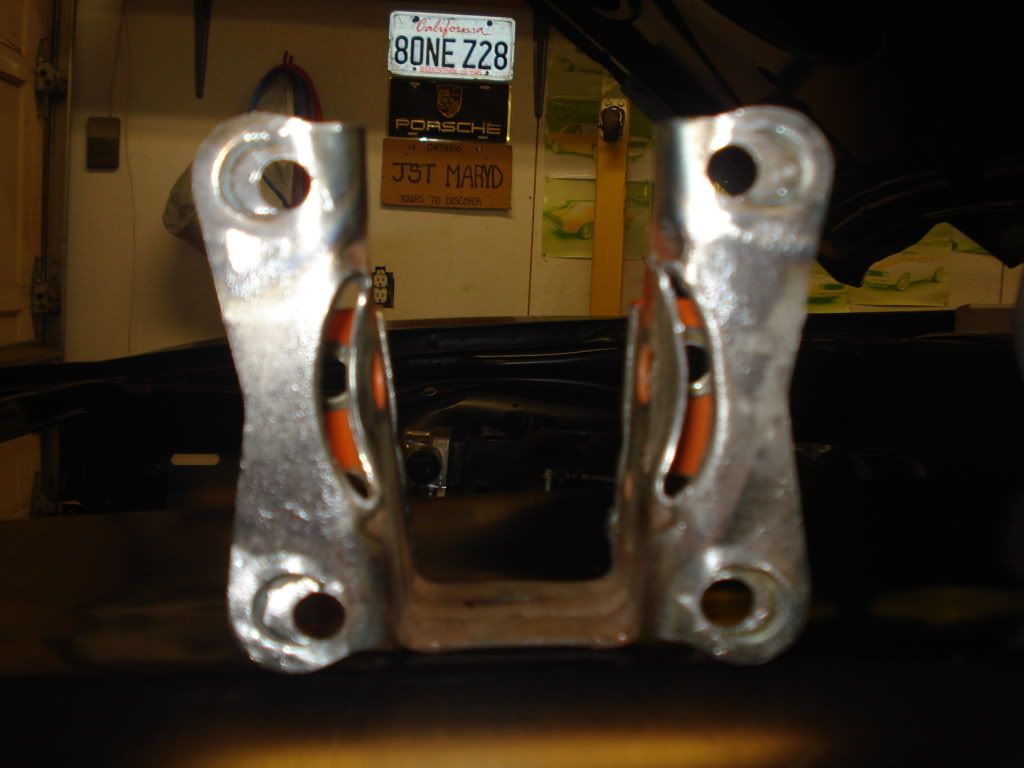

Well I have some more progress to show you guys.After dropping in my LS1 I ran into a few fitment issues.One in particular was my factory vacuum booster wasn't allowing one of my coils to bolt down.So I had a 2001 C5 booster and master that I wanted to use.So after talking to a few of our members here I went for it.Basically what I did was tranfer over the factory booster bracket and modify it to bolt onto the C5 booster so everything could bolt in smoothly together.Hopefully the pics are self explanitory but please shoot me some questions I"d be pleased to answer them.The whole process took me about 6hrs and it fits perfect.
