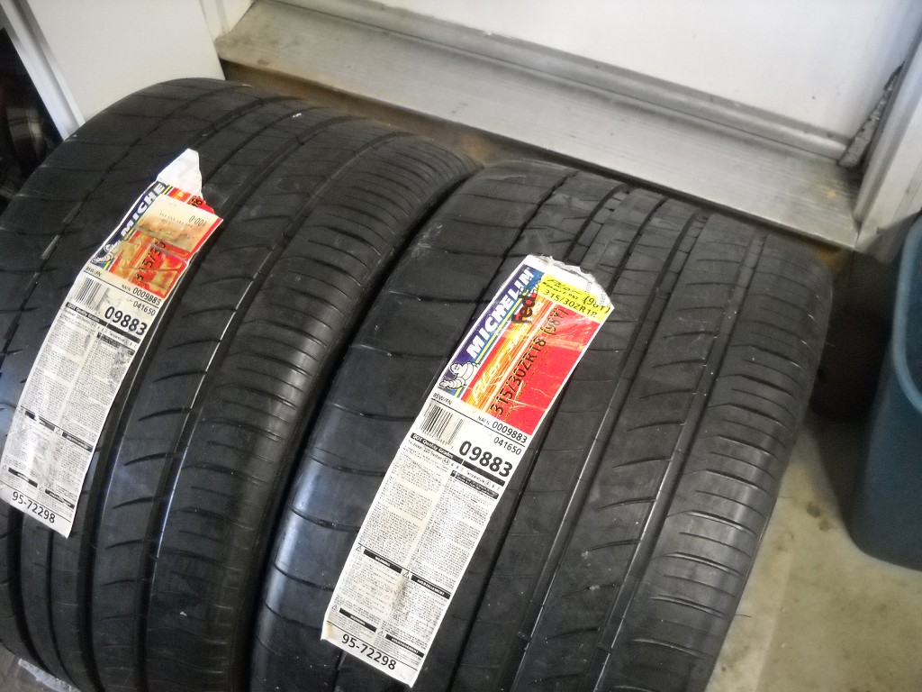

Christmas in May, gotta love the smell of fresh rubber in the morning! Had to fit them under the car just cuz.... Also received my SPI order today, now just got to get busy!!!
Got tired of waiting on Falkens!

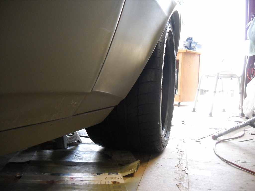

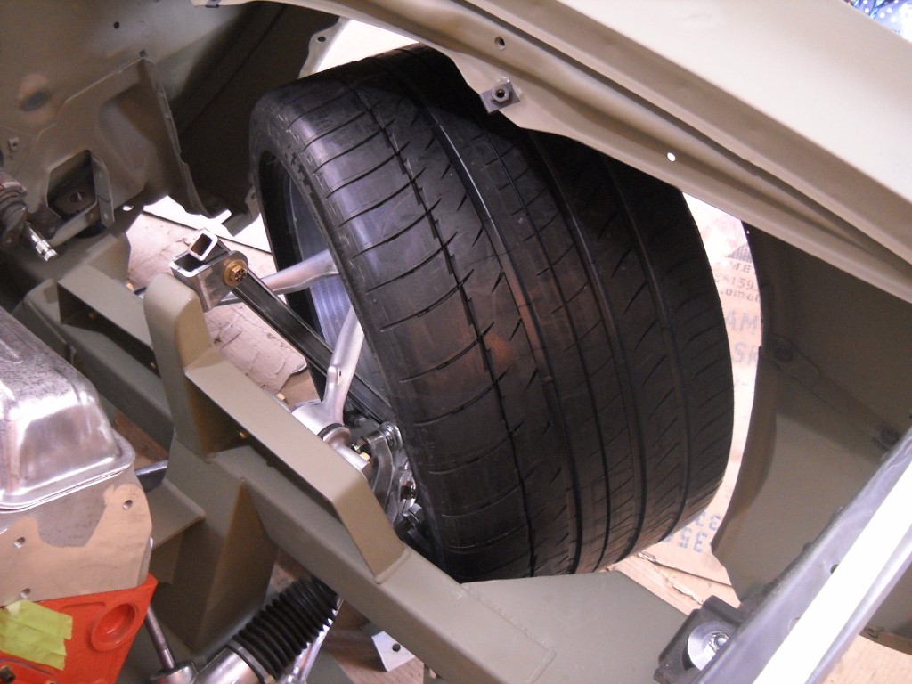

Plenty of room ... I'm next to rent the Wheel Rite tool and then its RIMS!
I think they'll fit just fine!!!
Nothing like steam rollers ....

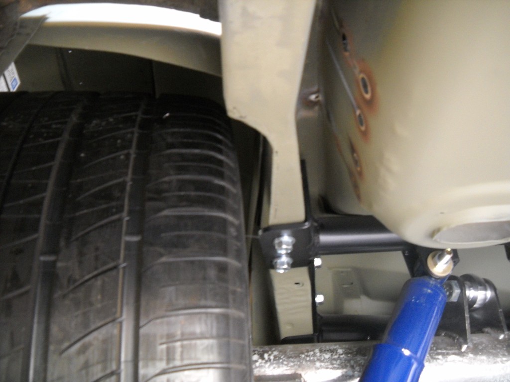

Coming along nicely! Like the color idea/choice.....should look real cool. How is the clearance looking on the g-bar for exhaust?

That I don't know ... if I go with a full length (Magnaflow 2 1/2) I might have to notch the trunk pan, or I could go under the axle and call it good!!

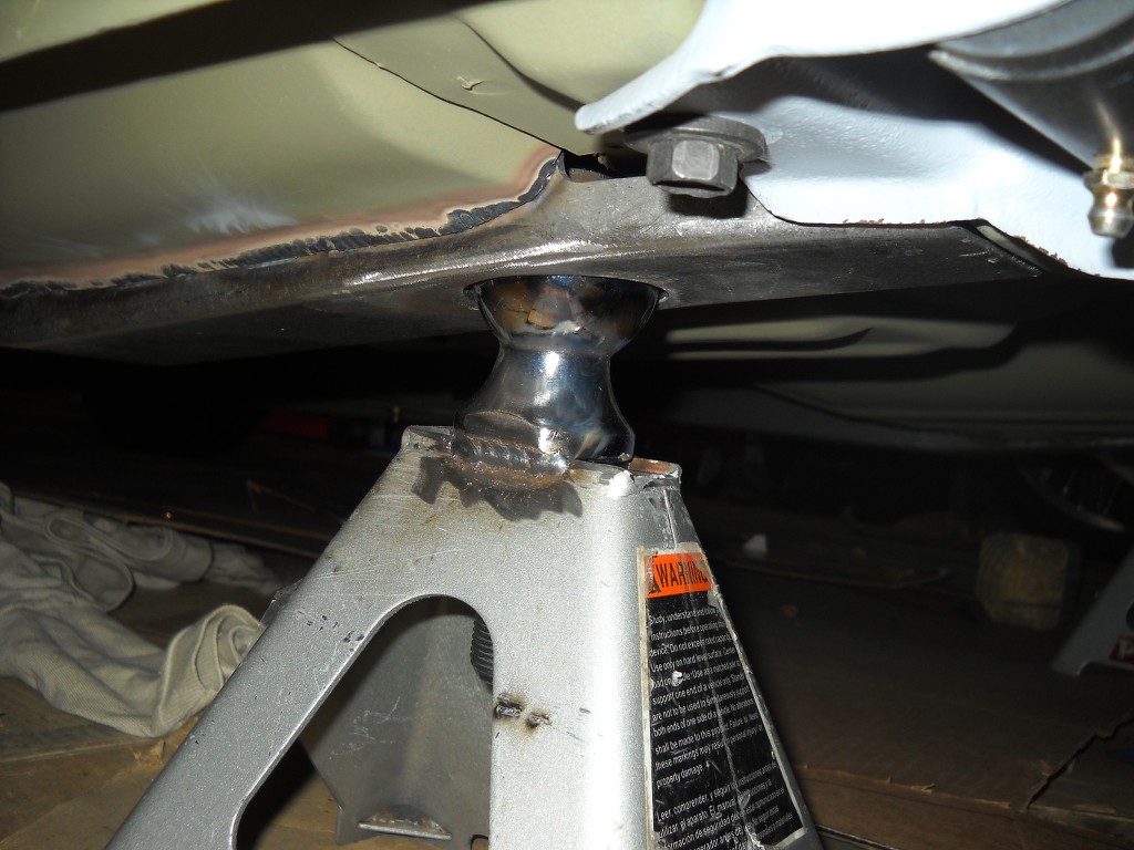

Not much here, just had to get out in the garage and do something ... so I made Version I stands for the frame mods that I did, I think I may want it a little taller for Version II .... or use limiting straps on the suspension!!!
Oh well, it's something ... back to homework!!!

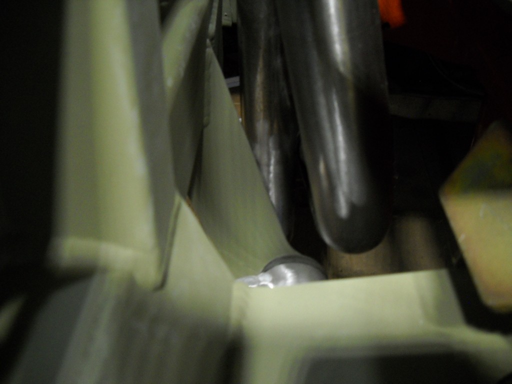

however there is some inference .... that's hot rodding, need to move the engine and tranny back an inch to clear the aft lower control arm brace, already ordered a set of misfit adjustable mounts from Dirty-Dingo and that should be taken care of! The adjustable mounts will raise the engine 7/16" and that will help some!
Not too happy about the ground clearance thou ... hangin' a little low, about the depth of the tubes 1.63". Don't want to cut them up right now, not qualified to
