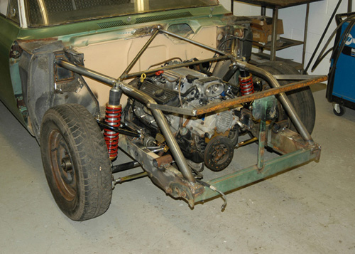

1969 rambler american......custom fabbed suspension..no boltons available..tubular upper and lower control arms..lowers bolt to custom tube ..bolton crossmember ..ill list some pics takes to long to explain what was done.rear has fabbed mount and adjustable torque arm and panhard..retained stock floor pans just mini tubbed(my first time.lots a work) .power from a lt1 -4l60e combo cooled by a dual 1 1/4 tube aluminum radiator and dual electric fans ....9 inch rear-370 gear posi .dampened by..carrera coil overs...body is mostly stock.minus sidemarker reflectors...the inner fenders and core suport we cut off...aluminum fabbed inner panels now in place.also a first for me ..lota first time stuff on this project....learning that all tis fab stuff takes more time than i ever thought...i probably have to many ideas ....haha...
