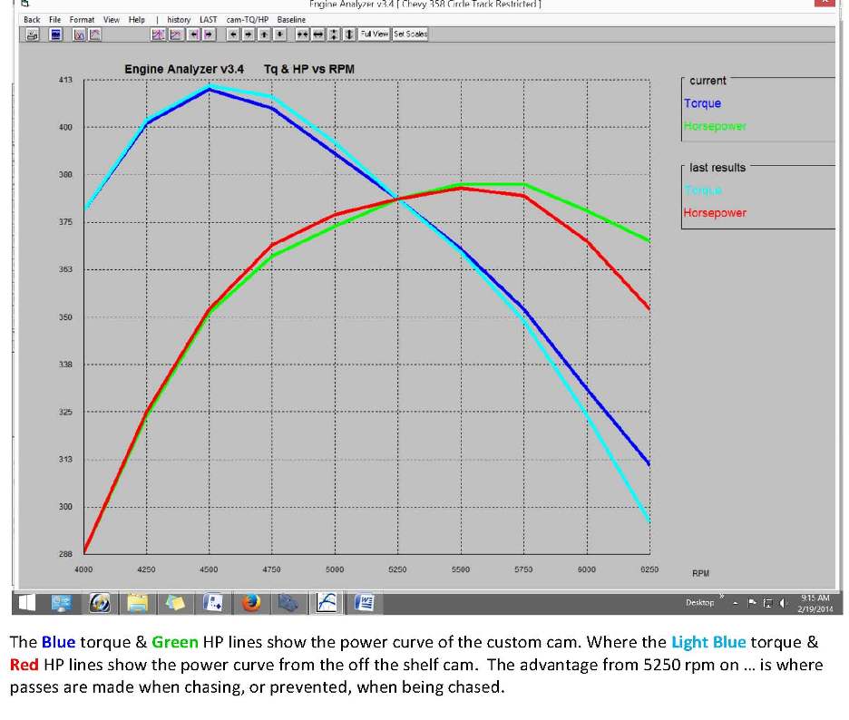

This dyno curve shows the off-the-shelf cam & the custom cam. The difference from 5250 rpm & up is key to a fast race car down the straights. This is the middle of the 3 cam profiles I was considering.
It will not be a torque monster. But it won't be lame either. the key to being fast with this combo is to gear the car to hit the 6300 rpm rev limiter 4-6' before the lift point.
The throttle won't be as sensitive. The car won't be edgy on exit about tire spin. The driver won't have to egg-shell the throttle. The driver will be able to roll the throttle on early & rapidly ... starting the acceleration ramp earlier.
From corner exit to the the next turn, it will be the best combo, if geared correctly.

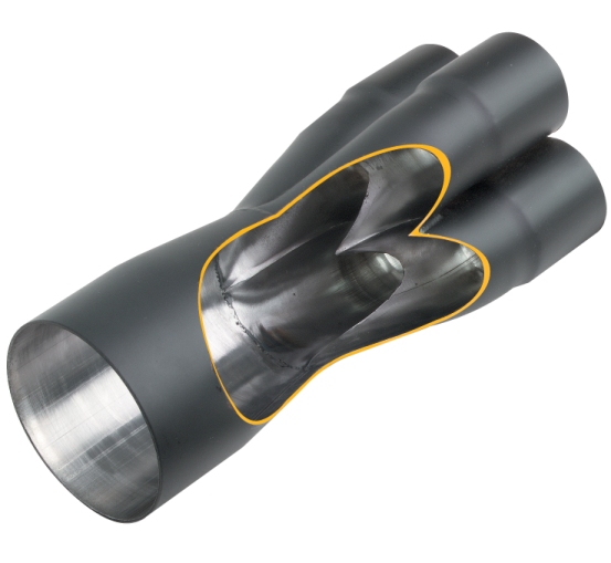

The collector needs to be 3" in diameter ... with a true "merge collector" diameter of 2-1/2" installed at 9.9"± from the end of the primary tubes. People often confuse collectors with merge collectors because the names are similar. A true merge collector necks down at a specific point & then necks back up. See the attached photos.
If the merge collector is designed correctly ...
* The 4 tubes come into the necked down area of the collector at a 10° to 15° angle
* There is a "merge tip" at the end of the primary header tubes, in the middle of the 4 tubes, that comes to a point.
* The collector necks down & then necks back up, forming a venturi.

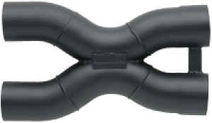

The X-pipe (photo at bottom right) needs to be centered at 39.6"± from the end of the primary tubes. This one is less sensitive ... and inch or two either direction is ok.

An less expensive alternative to true merge collectors are "Insertable Collector Reducers". (Photo at bottom of page)
They basically slide into the 3" collector material & run a few welds to hold it in place centered at 9.9" from the end of the primary tubes. I've used them with some positive results when the exhaust was too tight to fit a merge collector in there.

c. Place the center of Insertable Collector Reducers with 2.5" ID at 9.9" from the end of the primary tubes.
