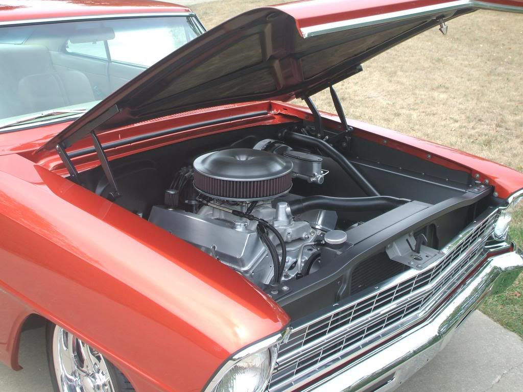

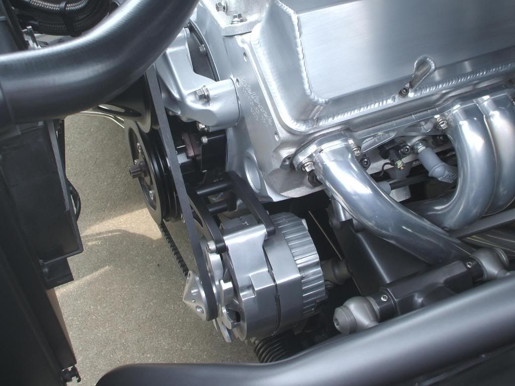

I use the Red Scotchbrites,
But then I have a coating I put on it to keep the aluminum from getting dirty, and it kinda dulls it down.

Its a Wizards product,
Metal Renew
If you can get your hands on Wizards products, just put some finish cut rubbing compond, it will do the same thing.
