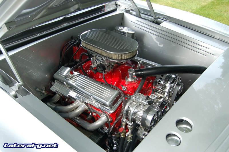

Default here is mine
hard to do something really different
That looks REALLY good!

I've got a Wayne Due C4 Subframe. I finally mounted the front fenders and inner fenders and the control arm openings on the inner panels are no where close to lining up with the C4. So, I'm trying to decide whether to modify the inner fenders or built some custom units to cover all of it up.

Did my inner fenders and I am using a 21st century subframe. Jim is also doing Jimmy Johnson's (#48) car and he modified the stock inners like you were speaking of. I can get you pictures of that if you like. It really comes down to if you want the stock engine bay look. I opted for the custom inners so I could hide wiring and hoses to clean up the bay a bit.
