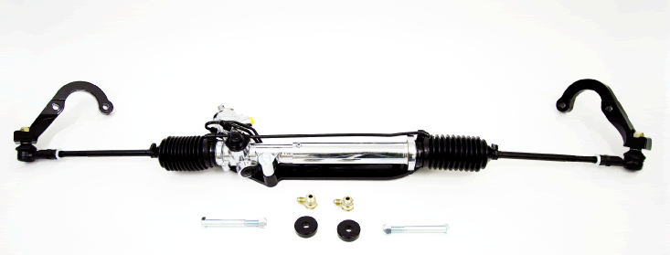

We have the bolt-in rack kits for your car in Manual or Power, Black or Chrome (shown below) finishes.

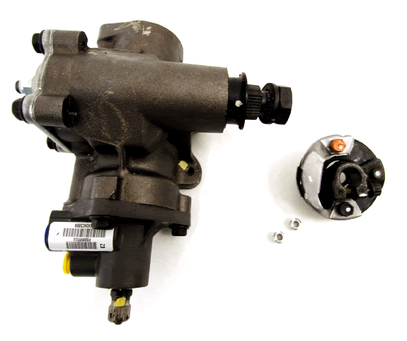

If you are interested in a modern gear box; we are now offering the best steering box ever offered by GM- Delphi. The GM “600 series” Power Steering Boxes were originally designed for NASCAR.
The GM 600 Box is slightly lighter than other power steering boxes and is available in several different ratios for optimal steering performance depending on the vehicle; 12:1, 14:1, and 16:1 ratios are available for this steering box. We offer this box alone or with the necessary rag-joint (coupler) and adapter fittings that enable you to use your existing sttering hoses.

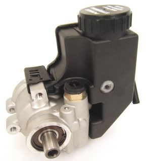

We also offer the correct GM Type II/TC power steering pump that is internally adjusted for the proper fluid flow and pressure to give you the very best “Box & Pump” steering available.
