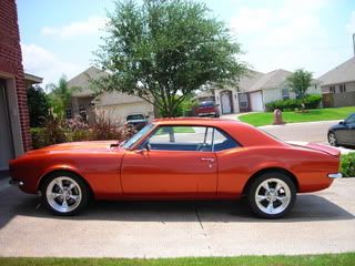

Hey Sunset, beautiful car, what are the widths of the wheels, and what did you do to get the stance?

Thanks, the wheels are 17x7 in front, and 17x9.5 in back. Although the yokohoma's on the back make the rears look wider. The rear rims have the wrong backspacing so they didn't fit perfect, although I got a swinging deal on them that I couldn't refuse. In the future, I am going to an 18" rim and at that time I may be able to stuff a little more in there. In front, I have BMR upper and lower control arms, stock spindles, and QA-1 coilovers. I don't have the front dropped all the way, I am running headers and they scrape bad the way it is with the roads around here. In back everything is stock, the pics make the back look better because my driveway is inclined. It is running pretty high in back. I am looking at going to a g-bar four link and a 9 inch as soon as I sell a kidney. Thanks for compliments,
