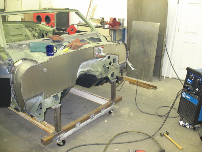

my brother actually smoothed the firewall on his 72 Nova using a sheet of thin gauge sheet metal. We just made a template out of thin plastic and transfered it over to the metal. He welded it in and then smoothed the edge with bondo, heres some pics before and after.

We cut all the bumps from the firewall then made a cardboard template. That was then turned into a single sheet of steel to cover the entire firewall.
That steel was bonded to the old firewall using FUSOR then welded around the edges and ground down.
Fiberglass would be a bad idea.
