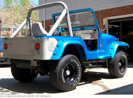

On our jeep project we went satin vs chrome/polished.
On the polished diamond plate and stainless steel & chrome we simply bead blasted the surface enuff to get a dull & even looking finish. This required shooting the aluminum with a matte clear coat, but the ss and chrome required no protective coating.
These parts have been in use and exposed to the elements for over a year with no issues to date.
