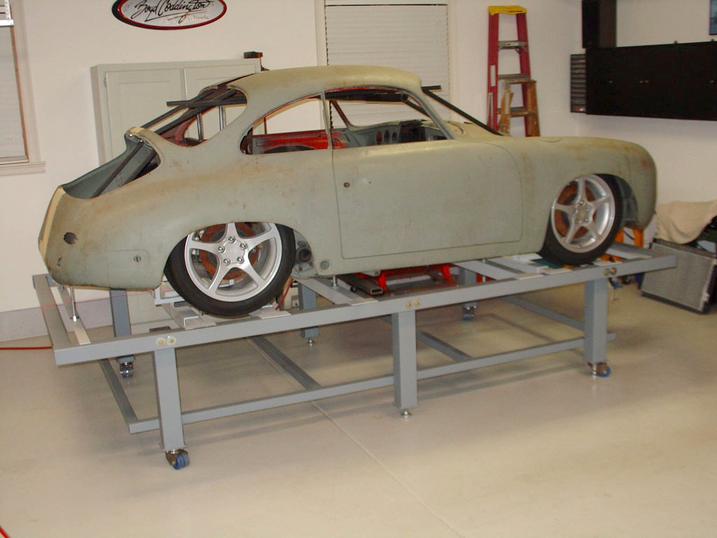

Think outside the box... what box ? We don't need no stinking boxes....
I have no clue how mine will turn out - or handle. But, It looks good and drives very well in my mind. I'll let you know.
I think all the mods you suggest are reasonable and have been done on all sorts of rods. Custom f/r glass can be a $$. My only concern would be the final look/proportion of the car. Could someone do a rendering or photochop of it maybe ?

Jim you read my mind about having the car rendered with the changes. I've emailed several and I should have that process started soon.
BTW: I LOVE YOUR PROJECT!!!!
I do understand driving in my mind. It handles great and my gas mileage, "OY VEY"! Hundreds of miles per gallon. ;-)
