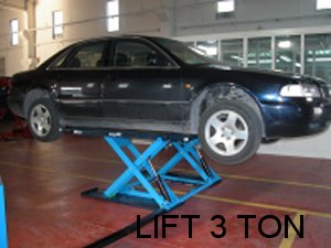

i just bought a lift myself, but since i dint have sufficient celinghright for a 1, 2 or 4 post lift i went with a scissor lift
