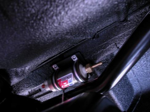

I will look this weekend it should be at Indy! I was under the impression the bottom of the car and the inside of the car...floor, firewall,rear seat delete area was all coated, it may not be rhino liner but it is some sort of textered coating!
Here a pic of the bottom of the 56 in there shop now this same stuff is on the sick fish!

I thought they coated over the powdercoating on the underside?

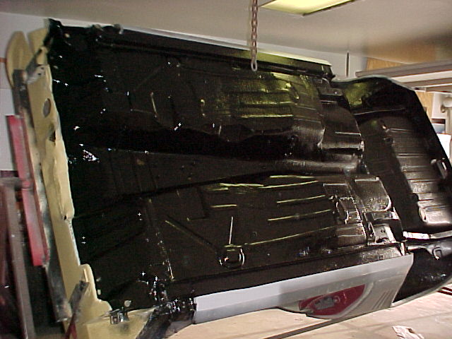

I coated inside and out of my 69 Vette pan and my 69 Camaro with truck bed liner. I thinned it down a bit to avoid excess build up where it was not needed. I shot the inner firewall and the ceiling, inside the trunk and backside of the quarter panels.
Cost?
You can get the gun for about $20 at most paint supply stores (body shultz gun). There are different types of "rhino" liner (epoxy, urothane, etc) and brands.
It usually runs around $100 or so for a two quart kit. You want to get the two part kind as it bonds better and should last much longer.
