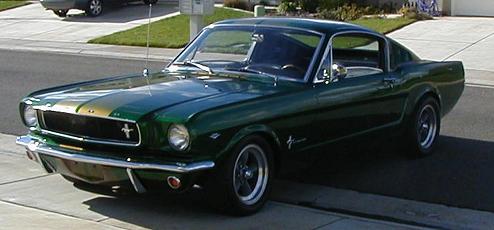

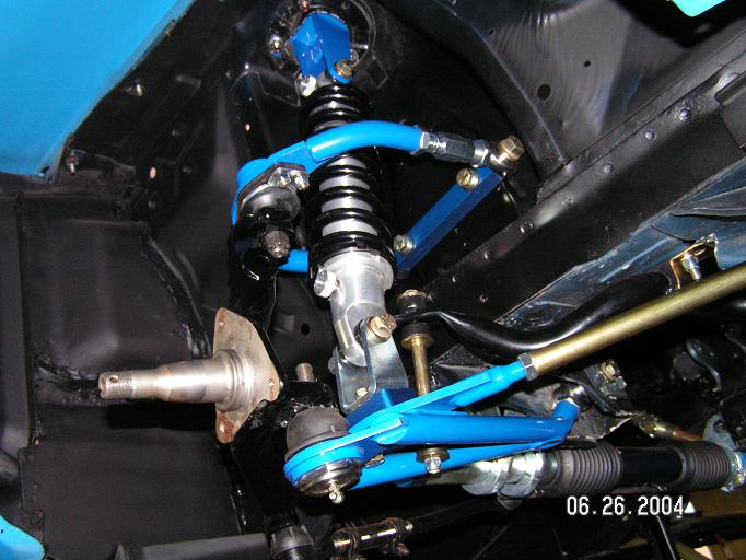

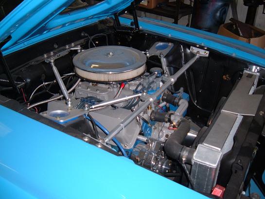

I have TCP and Global West on my three Mustangs. The 65 Mustang GT has all Global West with Delrin, the 1970 Grabber Blue Boss 302 has TCP front and back, the Grabber Yellow 71 Boss 351 has Global West. I would say both products are well made for these cars. Between GW and TCP, its hard to discern any differences but I like the adjustability of the TCP coilovers. I have not heard or experienced any problems like you mentioned, perhaps isolated cases? The car that handles best is the 65 Mustang and it has the GW but with TCP rack-n-pinion. It handles like its on rails. I reinforced the chassis on all cars with custom heavy subframe connectors, chassis bracing, engine compartment bracing, ect. If you have any questions, you can PM me anytime.

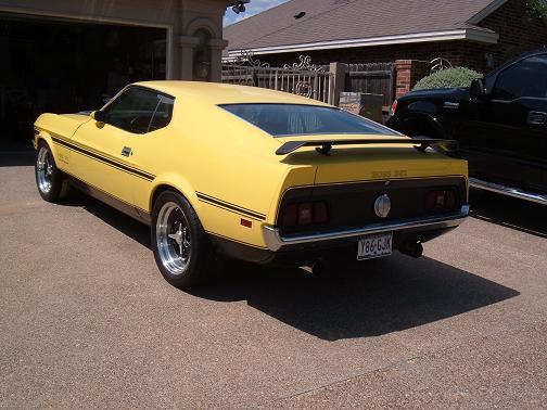

Funny thing the Salt Flats pictured on the yellow Boss were originally for the Blue 70 Boss but they did not fit since the six piston wilwood hubs made the front track wider and the wheels stuck out and rubbed. When I put them on the 71 yellow Boss, they fit perfectly. They are 255ft and 275rr on 17's. I will be trying 295's since these models have more space.
On the 70 Blue Boss, I will be fitting 17's on the front and 18's on the rear with 255's ft and 285's rear.
The 65 Mustang has small 15" BFG drag tires for now since it is really low and the picture does not do it justice. It will be hard to fit 17's without raising it 2" or so.
You can fit larger with small mods but I did not want to since they are real Boss matching #;s cars.
