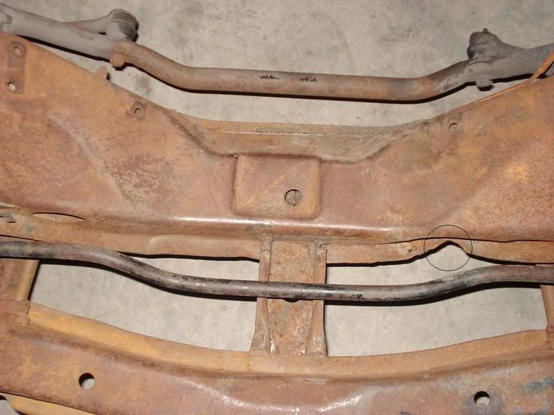

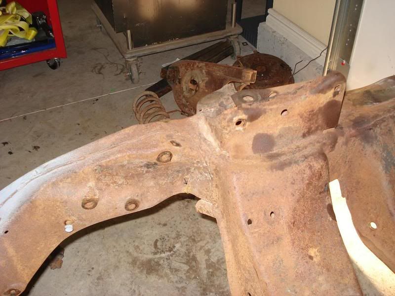

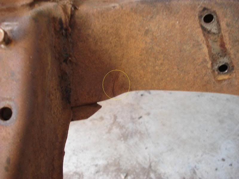

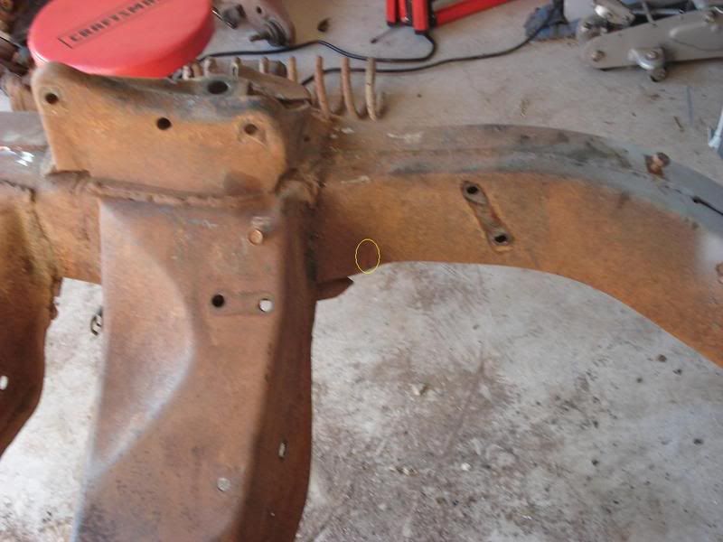

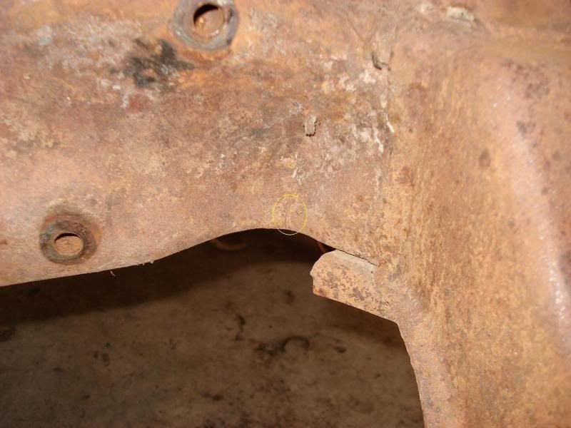

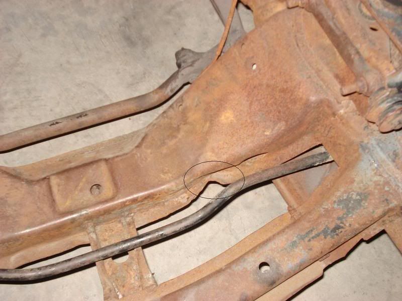

I tore down my stock subframe and notice all the oops that have happened to the subframe over the past 40 yrs. I have a couple hairline cracks, which I'm not to worried about. I'll probably just grind a groove in the cracks and then have it welded up. Then only real concern is a pretty big dig/dent in the frame. I was wondering what would be the best way to fix this, what about heating it up and then hammering it back in place? Here are a couple pics of the dig/dent and a couple of the cracks (close up and far away of the cracks).

The dent is probably the easy fix . It's Always best to straighten a frame
cold, but in this area a little heat won't hurt. The stress cracks are a more serious concern. Before You try to fix them take it to a reputable frame shop
and have it checked for Square, Level,and twist on all planes. Then have a Pro. do the welds. Rearwards of suspension is not an area to learn how to weld on. Looks like it's been on a Baja Run. Good Luck , Jimmy

I had a simular bend/dent as you and just hammer/dollied it back to shape. Then I stitch welded the entire frame....moving all around of course!
