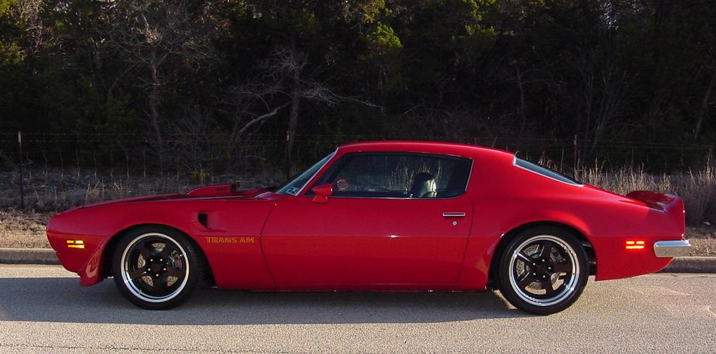

I think these are 18/20... Not 100% though... not a big fan either (may just be the rims)
Old 02-14-2008, 08:12 PM
cdoggy81 cdoggy81 is offline
Join Date: Sep 2007
Posts: 47
These I like!
