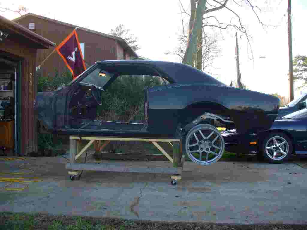

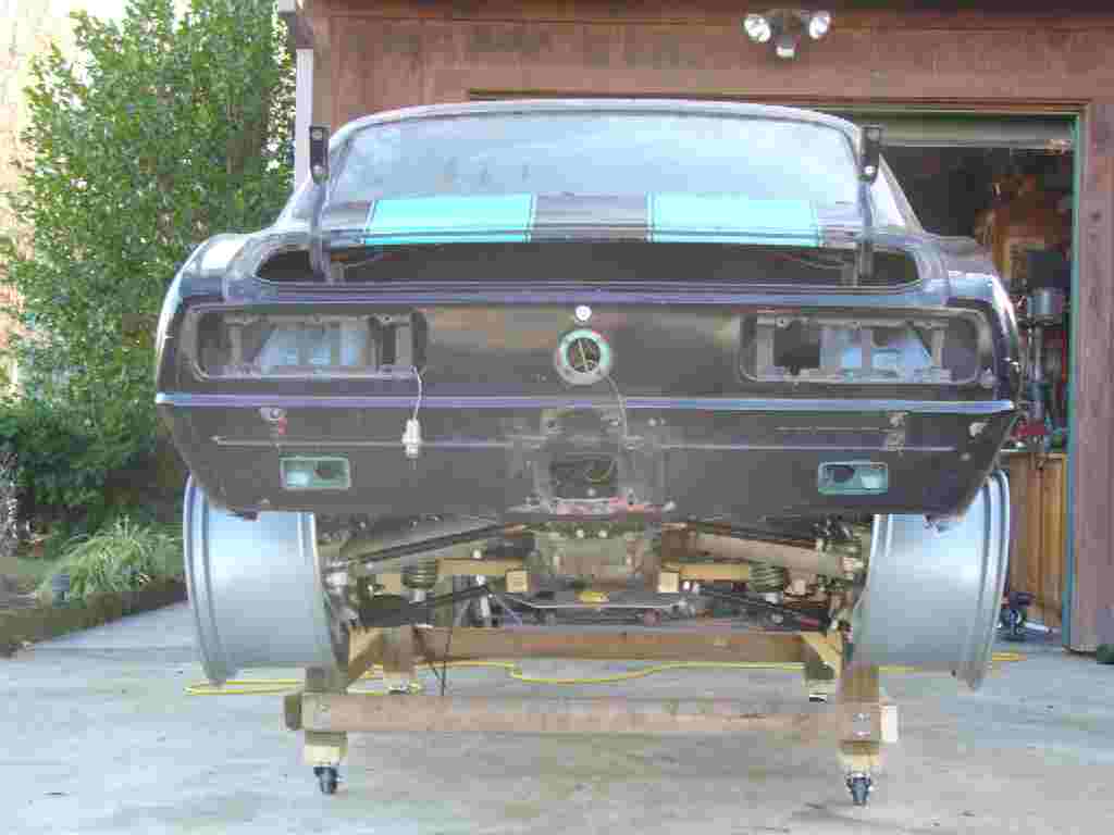

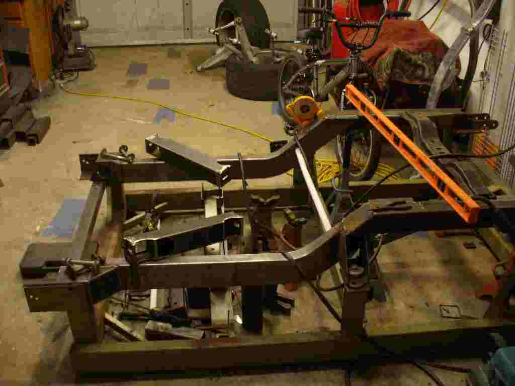

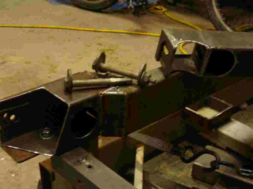

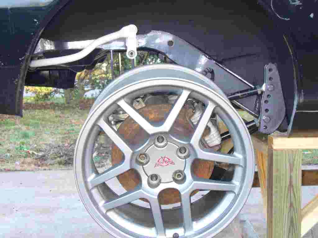

Hey guys, been putting some time in the Beach Cruiser since it's been too cold to do anything "beachy" The car is now off the roteserie and all sheet metal work in the floor and trunk is finished, the minitubs and subframe connectors are in and the bottom of the car is painted. Got my wheels over Christmas and started on my front subframe. It's a mix of all the C5 frames out there with a little bit of each thrown in with my own designs. I hope to have the frame under the car and down to the alignment shop sometime early spring. I want to make sure it's "Laser Square" before I completly weld everything up and start fitting the sheet metal. My motto is get it as close as I can with a plumb bob and a tape measure and make it adjustable. Got to get as much done as I can before the girls start riding thier bikes by in thier bikini's! Awful hard to concentrate!
