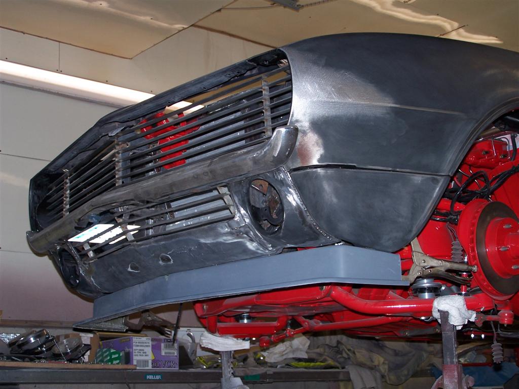

I love the look of a 67-68 valance with the 69 lights welded in.
Iv only seen pics of these WITHOUT the front bumper.
Anyone have any pics with a similiar mod with the front bumper on?? Or am I
trying to hard to accomplish two differnt styles into one????
Can anyone photoshop a pic for me (67 camaro)
Thanks

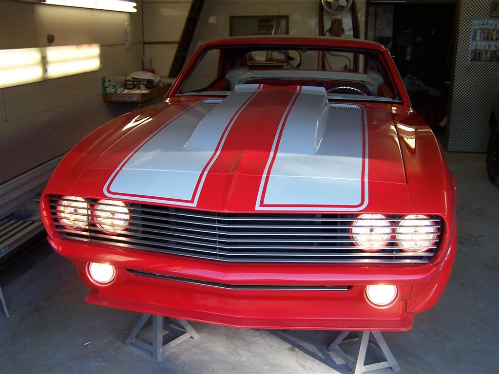

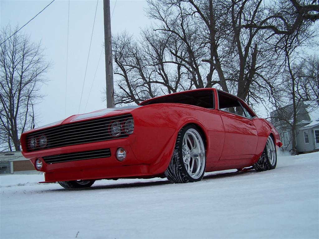

I used the 69 turn lite pockets and narrowed 69 bumper. Is this the look you were after?Name:  Picture 050 (Large).jpg
Name:  Picture 237 (Large).jpg
Name:  Picture 457 (Large).jpg
"Later" J.J.

What year is your camaro?? I like the front bumper idea- 69 shortend-Hmm...
Definitly in the right direction... I would just like to mount mine more towards the center
Did you weld your seams together on the front fenders???

It's a 68 and yes I welded the seam on the lower frt. fndr.ext.. I added to
lower rear of the frt.fndrs. too,
to match up with rockers.
"Later" J.J.
