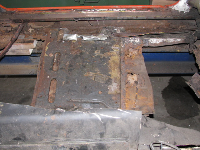

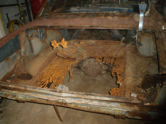

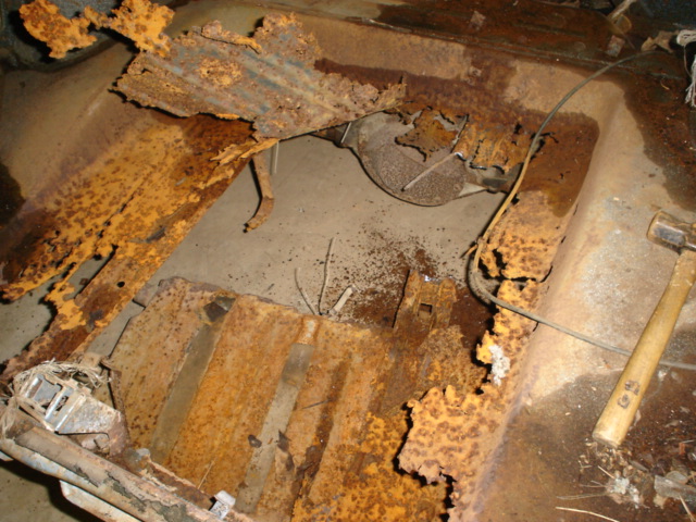

Here are some Pics:

Originally Posted by Musclerodz
The core structure needs to be saved, it is not available aftermarket except in a new tub. Are you figuring $20K with paint?
Mike excuse my lack of knowlege, but what do you mean by core structure?
Rocker panels?
