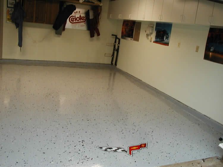

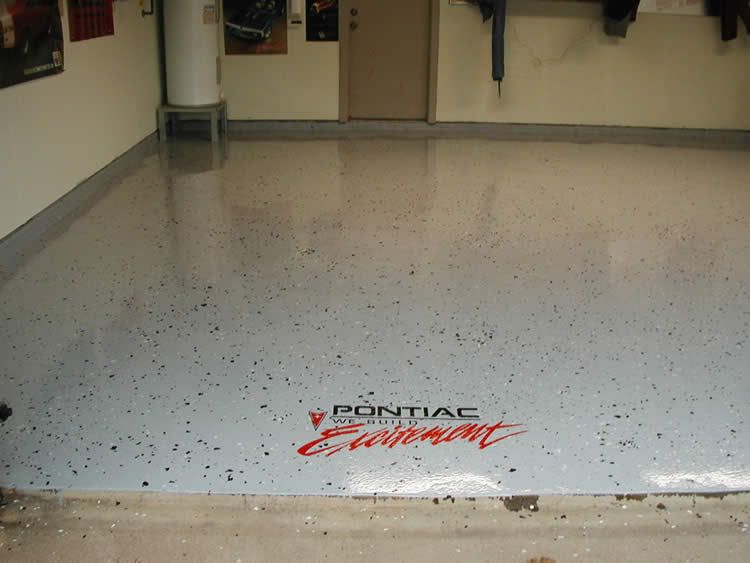

I did U-Coat It in my new garage hold up pretty good but does show scratches - been over a year now but they told me welding splatter is bad- havent tried that yet , cleans easy and is very slippery when wet!

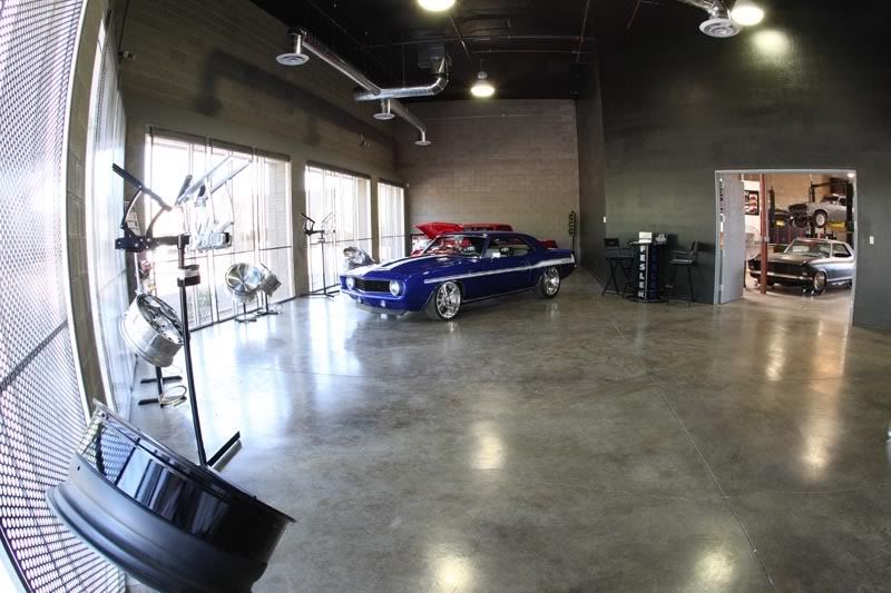

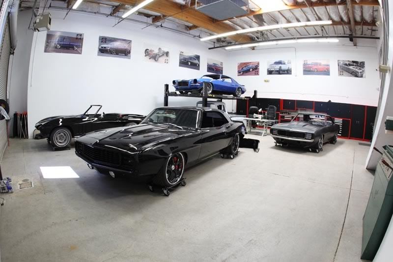

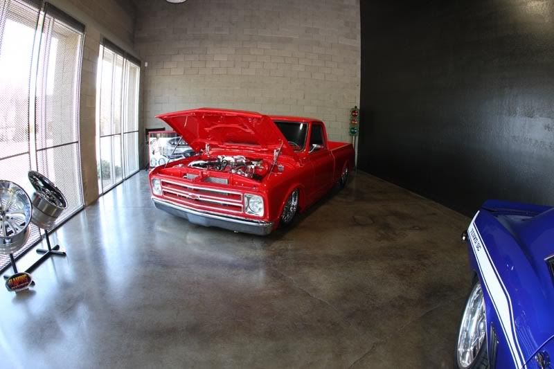

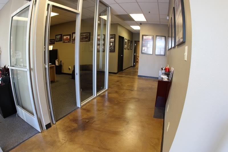

Check out our shop pics and look at our floors, they are etched and they last through the welding, sliding and its just the concreat. Nothing on top so you still have your same floor that will not scratch. they can do over 100 different themes on the floor so you have many options. I can get you the guys that did ours web site if they have one so you can see how its done.
Epoxy will not last if you are going to use your garage, you will see every weld splater on it. I know I have had two shops with epoxy and this time we searched for something new that would last and look sick. We have a big money home builder that we do work with and this is what they do on their floors and its cheaper in the long run.
