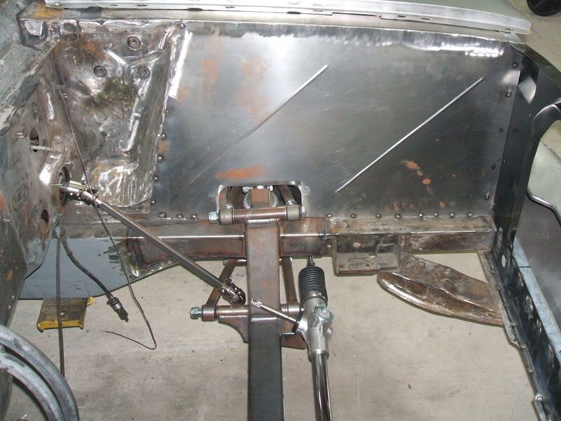

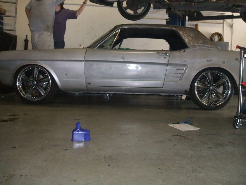

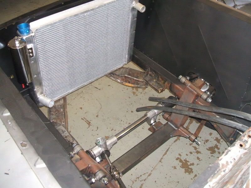

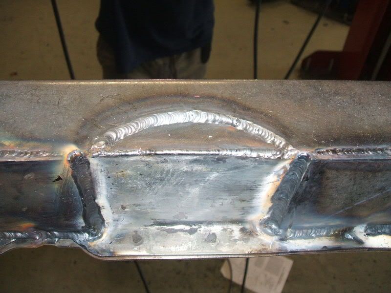

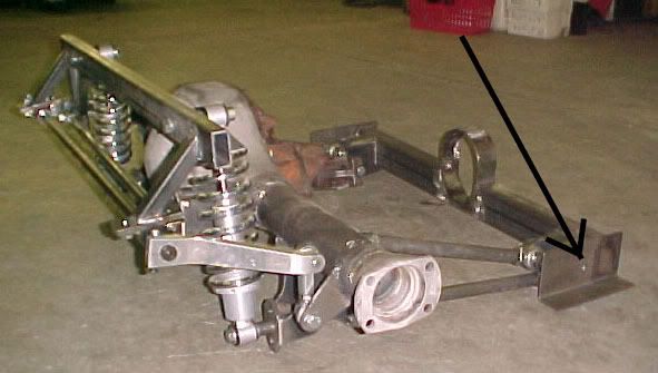

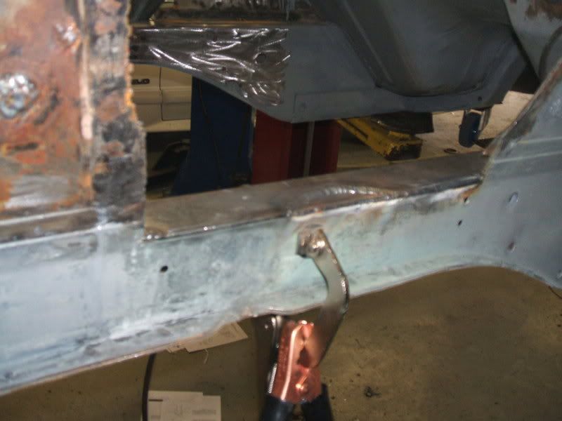

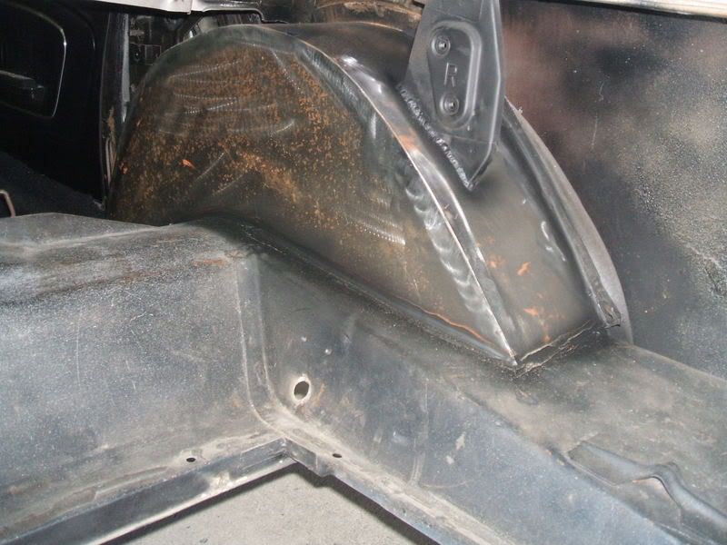

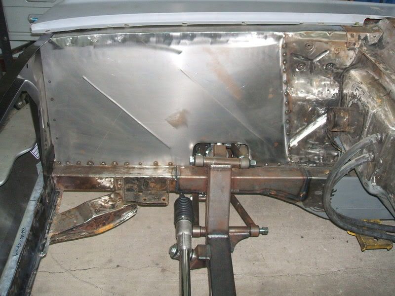

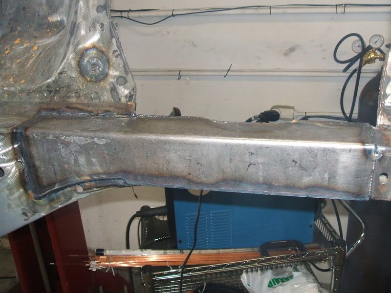

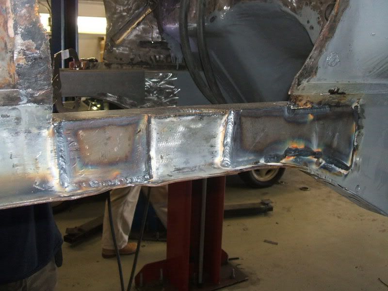

well so far so good .. installed a mustang two ifs and a rear four bar and the mini tubs time to strip the interior and make the body operfectly straight
also totaly smothing the firewall and installing vintage air system the car will be powered by a 07 gt-500 engine with a tko-600
it has four wheel 13 inch willwood brakes with polished calipers as well as a panhard setup in the rear.
wheels are foos nitrous with gunmetal centers 20x10 and 20 x 12
some pics so far
the ride height
front suspension work

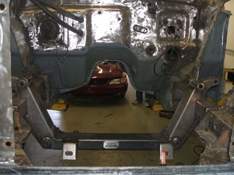

Default more
more

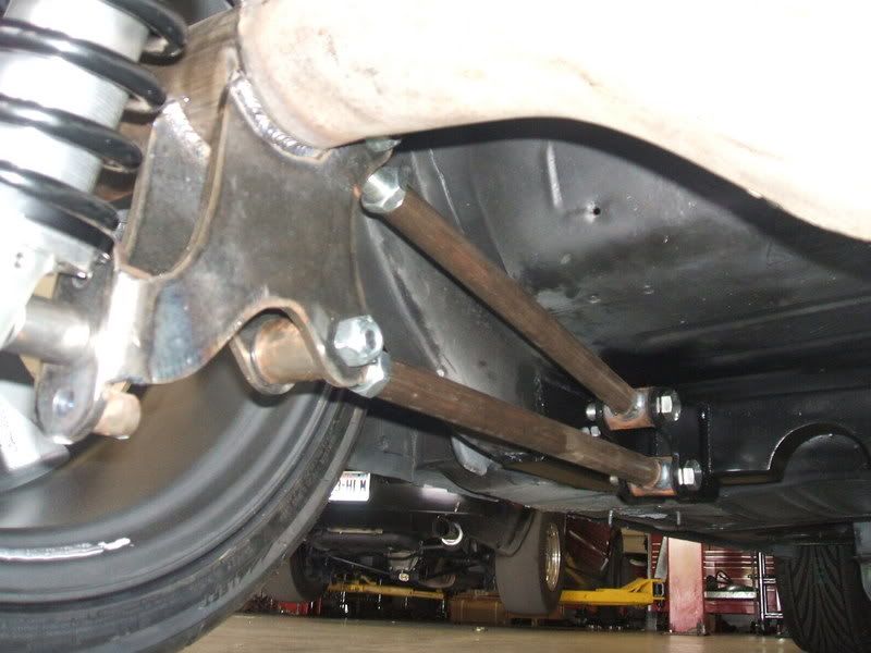

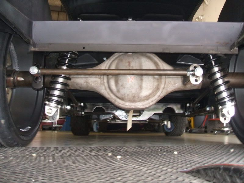

Default more
rear work

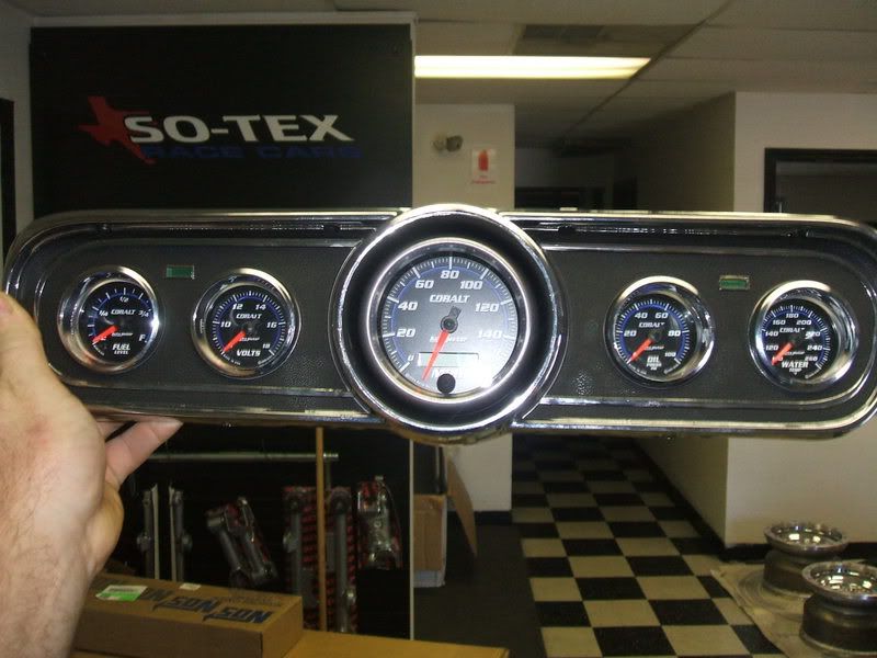

cobalt dash gauges

first thing i did was lift the car and wire brush the entire underside to bare metal then paint the whole chasis in por-15 epoxie so no rust worries over time. then i flat blacked it all.
