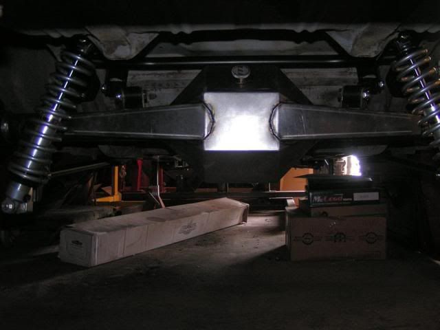

Well it some advice from many on this site, but I finally got the G-Bar/Air Ride suspension in. I am using QA1 coilovers. For those that wonder how hard it is to do yourself....it's pretty much idiot proof. Once I asked a couple questions ( https://lateral-g.net/forums/showthread.php4?t=14478 ) and got that issue out, it took me less than 4 hours including taking pics. That was with a G-Bar/Air Ride ready housing though. Thanks again to those that gave the great advice. Here's some advice that I can give now to those who are going to install this kit. Many people mentioned using a hammer, I never had to. I'm in the process of building a rotisserie and had tall bottle jacks. I ended up using those jacks to push the main brace into place. I've included pics of that. The jacks only cost me $40 each so even if you install lots of these, it may be a good investment as it made is so easy. Oh...by the way Frank...the coilover shocks cleared the back brace. Again, thanks to Frank at Prodigy Customs for having the brackets welded onto the M9 housing, made my job way easier.
Bottle Jacks in place
Bottle Jack attached to main brace
Rear suspension is in!!!

That is one sexy set up. But dont tell people it only take 4 hours, we have been charging 8hrs! LOL! Seriously, looks killer with the M9 and backbrace. Glad to know the G Bar ready rear made it easy

That's good point Frank. In fairness to you and all the other shops that install these, I don't want people to think 'hey it only took him 4 hours, why am I getting charged more'. It took me 4 hours to install just the housing and suspension parts. I haven't put in the axles, centre section, brakes, brake lines, etc. Also, I didn't have to remove anything as my car is just a shell right now and everything has already been removed. It would definately take alot longer than 4 hours to install everything and have it ready to drive. I was just trying to give some hope to those that do decide to take on the challenge themselves.
