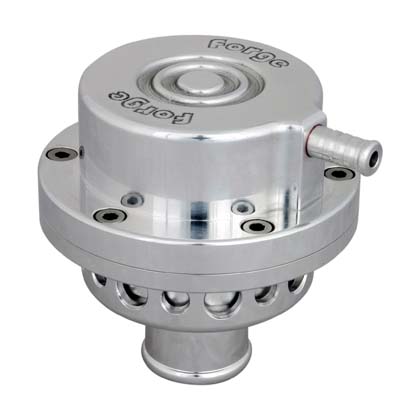

I use a lot of Forge BOV's and recirculation valves depending on the application. They are billet aluminum and can be setup as a release to atmosphere or reciculate if used behind a MAF sensor. For install they can use either a 1-1.25" nipple to go on a hose, a weld on fitting or there are a couple flanges available.
I am trying to attach a couple pics. Prices are genrally $125-175 shipped in the lower 48. Hope this helps.

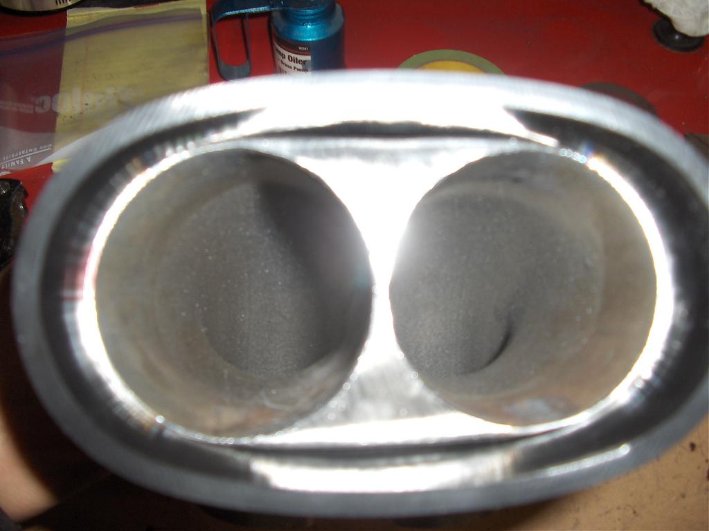

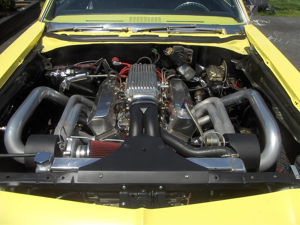

Thanks for the information, i have one more question i have a two into one piping off two seperate intercoolers, do i need one BOV on each, the pipes merge at the throttle body. i only have about an inch or so of combined space on the boot/clamp. i have attached a pic.
Thanks Joe

i would run a smaller bov on each tube unless your running a lot of boost then i would say due twin tials or turbo smarts.
there is very little area for the preasure to pass from one tube to the other there so i would think it would be very hard on the Tbody unless you ran duals on each pipe
also the cheapo chinese tial copies work just fine and save you about 120 bucks per valve heh

Thats is what i was thinking, i will go with the two BOV right before the merge at the throttle body. Thanks for your ideas.

The other thing you could do is fab a small merge pipe before the TB and mount a single BOV... it'll be a lot cheaper.
