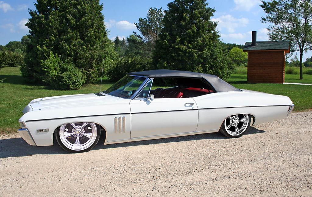

Ps.: I added a Photoshop-Fake of my Project, although I dont think I can go with 20īsince I will have traction problems anyway, so I will go with 18īs and more sideheight since a lot of people told me that will make my 0-60 time far better.
