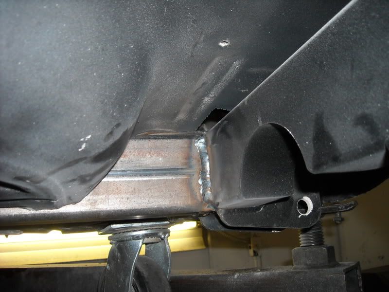

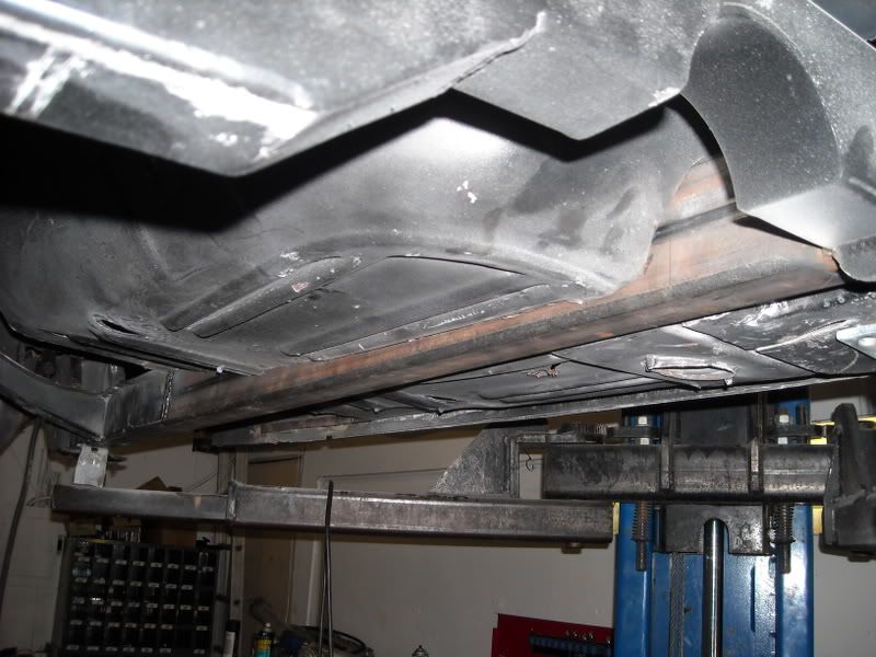

started in on some more work will be working on it very much in the next few weeks will prety much have some more pics every day.
here im cutting out the floor pans to replace the few rusty spots and at the same time installing a full 2x3 frame sliped inside the stock front frame and then welded to it and to the 2x3 crossmember for the four bar rear suspension wich is weded to the rear frame and the floor prety much giving me a full frame.
when im done ill cut the same chanel out of the new patch panels and weld them in to the floor pan and to the new frame rail and the old frame rail lip as well.

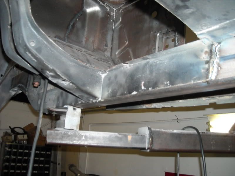

front suspension work
rear wheel tubs

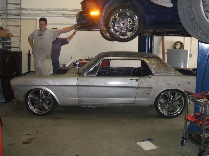

the stance

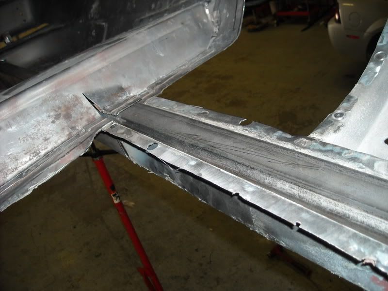

the fender lips
im going to cut them off leaving only a 1/4 inch lip and instead of stock bolts im going to use button head stainless 8th inch allen heads with nuts on the back side of the new upper panel for a ultra clean look.

i'm also working on a 66 coupe. love the stance and wheels. keep us updated on your project.
