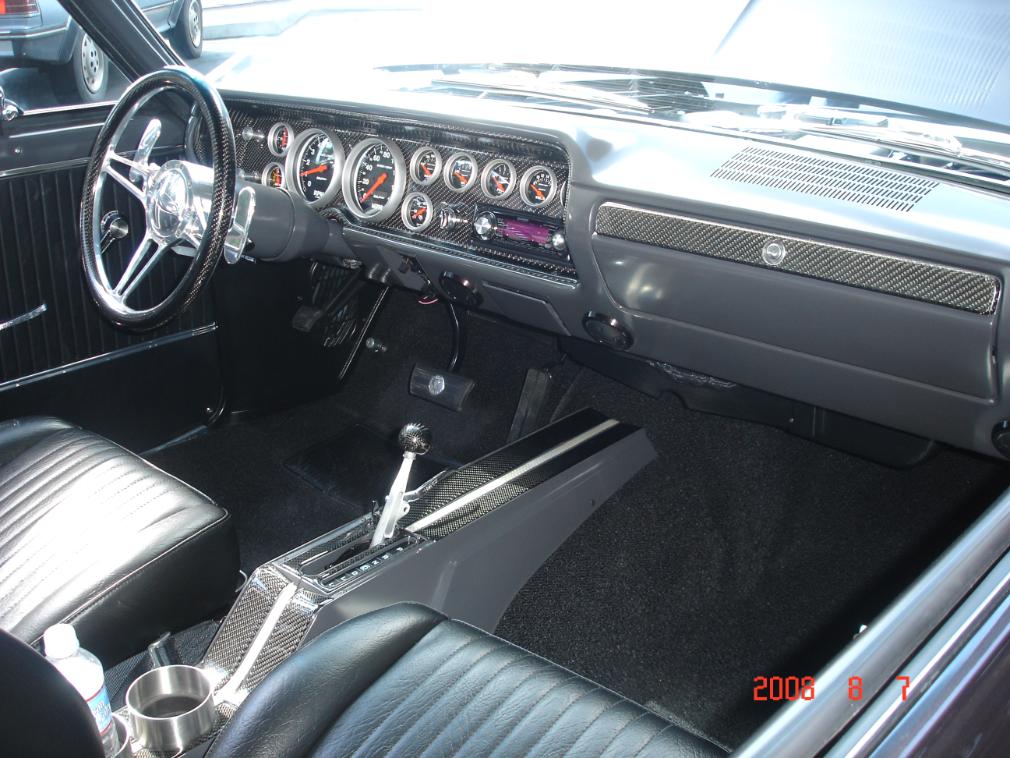

Where did you mount your boost controller?

Mark had it mounted under the dash, left side of the steering column. You can't see it, but the knob is just accessible to adjust boost while sitting in the car.
