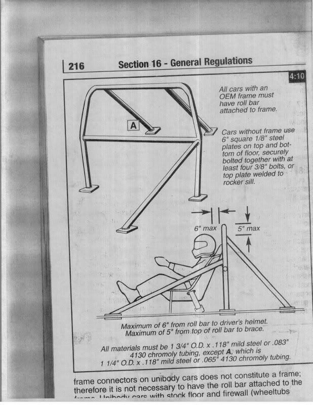

Does anyone have a current set of rules for NHRA they could possibly scan and email to me. I need the portion on cages. I have a customers import car that I got to build a legal 10.0 cage in and need the specs. I've read the cliff note version on the NHRA site, but would like to have the full deal if possible. Thanks

If the car is "never" going under 10.00, all you need is a rollbar, not a cage.
Is the car unibody (most likely ) or frame?
I simple 5 point bar is all that is needed.
Sorry, this is the best I can do without cutting up my book.

are nascar style door bars allowed and legal. He is wanting a full cage with a door bar like this

No the side bars ( nascar stylr) are not legal the side bar must pass mid way between the sholder and the elbow of the driver in a seated position. you have to ues 1.75 (for a roll bar)x MINIMUM .118 wall material. most guys if using ERW tubing use .134 wall cuz the wall thickness is so inconsistant. if your doing a cage then you would use 1 5/8 material DOM tubing you can get away with .120 wall material it's more expensive but better quality.
the design of the cage changes if more than 3? square feet of the original floor or fire wall is removed, then you need a dash bar and i think rocker bars? just going from memory.
gotta have 1/8 6x6 pads welded to the floor pan at each mounting location or one 6x6 on both sided of the floor pan boltet through the floor with 4 3/8 bolts ( this option sucks)

Those rules are great if the car will ever go fast enough to be mandated to have it. Otherwise it does not matter. If memory serve me correctly, it needs an inspected cage at 9.99 or faster and just needs some form of cage at 11.99. My buddy has an old arc welded rollcage in his 55 chevy and he run 10.50's all day. To have a pro-touring street car that will run faster then 10's on the street is pretty stout.

I figured the nascar setup wasn't NHRA legal. But thought I would ask anyway. This little car is bad, its a 98 Nissan 240SX with a big turbo 4 cyl. 2100 lbs and 700 HP. Has slips for 10.49 in the quarter and will pull a G in the skid pad also. SEriously setup little car!!
Now I just got to get the right tubing. Choices are use 1.75" DOM which I already have th die for, or use 1 5/8 and order a new die. I'll post up some pics in the coming days when I start bending tube

F.Y.I. the spec for a rollbar dropped a couple years back, you can now go 11.50 before you need a bar.Thank you Corvette and Viper.
Some tracks may let a car run with a subpar bar/cage.
I noticed on T&T nights, they check belts and helmets and send you on your way.
At an event, the put the glasses on and look the cars over pretty good and let the small stuff slide.
NHRA sanctioned event, the microscope comes out, one problem NO RACE.
I prefer to meet or exceed the safety rules, it's "only" my life or maybe the guy in the other lanes!
