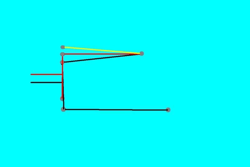

I am sitting here eating lunch and made a very crude drawing of the idea and think I will still get "some" benefit of the taller upper.
This is not to scale or the angles right but you should get the idea.
The Black line is stock.
The Red with "raised lower"
The Yellow is "raised lower and upper"
With the raised lower, it appears the the lower pivot point is the same and it "pushes up" the Upper, so the distance between the two is greater.
Adding the raised upper, moves them apart further.
Keep in mind, I am doing this all in my head ( scary place too be) and am trying to learn here.

Dr.Deuce is right,tall lower ball joints can be very beneficial in the G chassis. BUT you`re not working in a vacume and there`s a lot more at play here than just ride height and camber curves. Roll center height, roll center migration, FVSA length and especially bumpsteer are all greatly affected as well. If you just want to lower the car trimming the springs is the quickest and by far the easiest way. If you want to greatly improve the handling and steering characteristics and lower the car some give us a call and we`ll fix you up with the proper height taller ball joints for your application. Expect roughly 3/4" of ride height reduction. Interestingly ride height reduction and ball joint stud height increase are not 1:1. NOTE: If you make a substantial improvement in the geometry using tall ball joints the stock upper A arms will have to go. It will physically bolt together but you won`t be able to align the car even to stock specs let alone good performance specs and you`ll have limited bump travel without binding the upper ball joint in the arms so expect to change the arms as well. Basically the end result of doing what you want to do and doing it right is this http://scandc.com/suspensions.htm#streetcomp2 Mark SC&C

Adding a balljoint with a longer shaft will help. Simply moving the mount of the ball joint up does nothing for geometry. It still pivots in the center of the ball.

if you move the lower ball joint mount it will certainly affect geometry because you change the relationship of the lower ball joint and tire contact to the inner lower and upper pivot points

Yes, I should have said nothing good. The Roll Center and camber curve would get worse.

that is exactly what tall balljoints are... cylindrical shaft before the taper.. moves pivot in relation to spindle,
